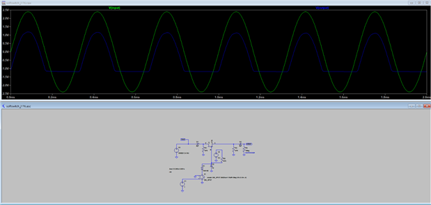

But when the amplitude of the input rises (I've put the dashed cursor B at the level where the effect becomes obvious), the source no longer follows the drain.
What's happening?
image: oscilloscope capture when Gate-Source Cutt-off is crossed
To see that, check the dark blue VGS signal.
At a certain point (I put full-line cursor A there), VGS reaches the Gate-Source Cutt-Off voltage (VGS(off)).
According to the data sheet this is between 1 and 4 V for the J176.
For my transistor, it happens to be around 1.3 V.
VGS is the diode drop - VG. So that gives us an AC leeway of 1.3 V - 0.5 V = 0.8 V on the negative side.
An AC signal with 1.6 Vpp is just manageable with my JFET.
Increasing the supply voltage will not help, because the diode drop is the deciding factor here, and it's reasonably flat when using large pull-up resistor that draw only small current.
source: ON Semiconductor datasheet for J176
The effect on the output is pertinent. Once the signal pushes the source low (and as such increases the positive voltage between source and gate), you get closer to that cut-off point.
One it's reached, the FET stops being the linear resistor it was and the output gets strongly attenuated.
It's some kind of self-balancing system because the further above the cut-off, the stronger the effect.
This will render the negative part of the sinus input signal into a flattened, lob-style curve, while the positive half is still good.
Here is LTspice's take on this situation:
image: LTspice simulation, taken at input and output before and after the decoupling capacitors
The output is slightly attenuated vs the input in LTSpice because I measured before the input cap and after the output.
I can easily change that, but maybe this can be an exercise for you? The model is attached to post #1.
Given this effect, and taking worst case (VGS(off) = 1 V), we are still safe for a consumer product's line signal.
To handle professional audio line levels, you should consider  a J175 or another JFET with a higher VGS(off).

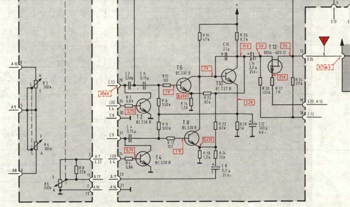

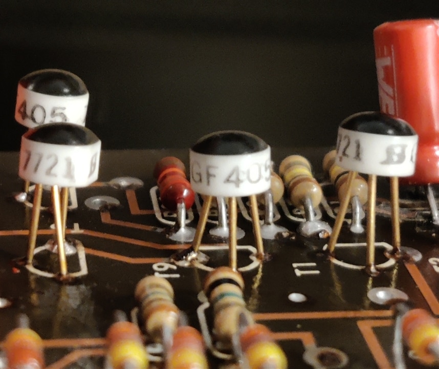

    This is a very interesting post! Thank you for posting this! I found it while searching for a replacement JFET for my Grundig TS1000 reel to reel recorder. This recorder uses a JFET type GF405 to switch audio signals. There is no replacement nor information for the GF405 on the net. T12 on the schematic.
    Could you please give me a tip witch JFET type I could use as a replacement? Are there some types that "sounds better" for audio applications?
