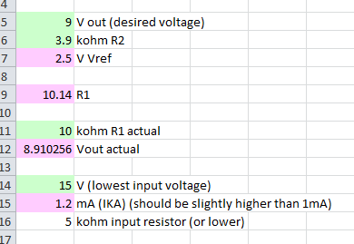

    I end up with loads of text files, excel files, just containing notes on each topic. Usually lots of notes into a paper lab book too.
    If I do any calculations I'll try to put it into an excel file so I can re-do the calculation at a later date if things change.
    I use two colours so I know which things are inputs to the calculation and which things are intermediate results. Here is a random snippet (some voltage regulator calculation). This is just my work style, others I'm sure have better methods.

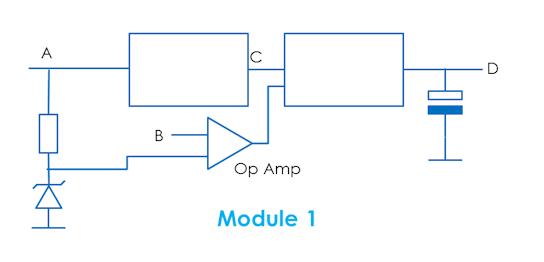

    Also a high level diagram helps loads. It means I can work on sections and not lose sight of the bigger picture. Also means I can show others what I'm talking about and can use the same diagram for documentation. Something like this, although it could just be sketched out roughly too, no need for it to look fancy.
