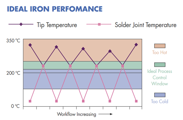

    EDIT: Just noticed this diagram in some PACE brochure here (PDF), which might say it better than my poor description/anecdotal results above.
    The brochure doesn't mention the initial tip  temperature either, the actual value can chosen can vary for different situations such as tip size and iron power.
    However you can see tip temperature drop as the joint is made, and simultaneously the joint temperature rise as the joint is made, and they unite at an intermediate point.
    Of course, even though they say this is 'ideal iron performance' the brochure is 9 years old, and technology changes. So I guess such old information could be taken
    with a pinch of salt or just of historical relevance, all I can say is that it appears to work for me at some 330-340 degrees C tip temperature. You may have more modern
    gear.  The irons mentioned in the PACE brochure (TD-100) are still current models on their website and available from Farnell, so such a graph might still apply to these
    particular irons but this is a guess. I'm not knowledgeable enough in soldering process technology to know what improvements have been made in recent years.

    The use of overly high temperatures is to compensate for product flaws and poor technique.
    The PERFOMance graph even shows it and says that the tip temperature is "Too Hot".
    shabaz over 10 years ago in reply to COMPACT
    Overly high is of course bad, but what is overly high?
    Not sure they're saying a flawed product would exhibit the behaviour in the graph.. because the pink line shows the solder joint temperature correctly
    going up to reach solder joint temperature, and it never goes into the 'too hot' zone. It goes into the green 'Ideal' zone per solder join.
    I was under the impression PACE tools were quite high-end, and it is a currently shipping product.

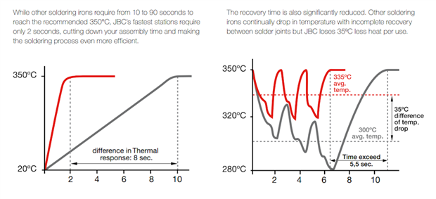

    Also there is a JBC brochure that shows a similar thing, and they explicitly mention 350 degrees C to be recommended in their text.
    The graph on the right clearly shows how their iron bounced back to 350 degrees C after each solder join, whereas the
    gray line (competitor iron) couldn't recover so quickly. The JBC graphs do not show the solder joint temperature, but it too would have
    started at cold and then would have risen as the heat was applied until it was in some ideal green zone.
