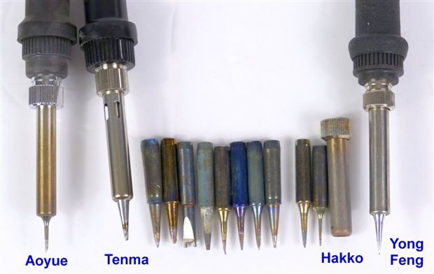

    Pictures really tell a lot in a thread like this so here are my irons and a collection of old tips:
    The Aoyue is the iron part of my hot air rework station - I don't use the iron part much, because it isn't as good as the Hakko I use most of the time (I didn't bring the whole Hakko over for the picture).
    The blue tip in the middle is the one I am currently using in the Hakko.
    The Tenma is new, courtesy of element14 - only used in my camera area so far.
    The Yong Feng looks unused because it is - I bought it for $12 - it might see some use for mobile work since the temperature control is in the handle, eliminating the big controller block.
    Some of the tips have a worn spot that doesn't "wet" with solder well but I don't throw them out in case I want to use them for melting PLA or hot glue or some other application that would mess up a nice tip.

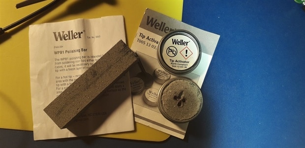

    Jan Cumps over 6 years ago in reply to dougw
    dougw  wrote:
    Some of the tips have a worn spot that doesn't "wet" with solder well but I don't throw them out ...
    For those cases, I use these two:
    As you can see, I don't use it often. Only when I create spots that don't wet (typically when melting a connector away with the iron because "it needs to go" image )
    The polish bar and activator are not to be used when the tip is OK. They are not maintenance utilities, but repair. They have downsides.

    fmilburn over 6 years ago in reply to dougw
    What is the strange tip with two bumps on the edges used for?
  • 14rhb
    14rhb over 6 years ago in reply to fmilburn
    For fixings like this when you can't find the proper driver?
    PS: I do know the real answer but will leave it to dougw as it is his soldering iron selection image
    • Vote Up +5 Vote Down
  • fmilburn
    fmilburn over 6 years ago in reply to 14rhb
    Looks like it would fit in the chuck of my electric drill OK which would reduce the stress of using it with the soldering iron for a handle  image
