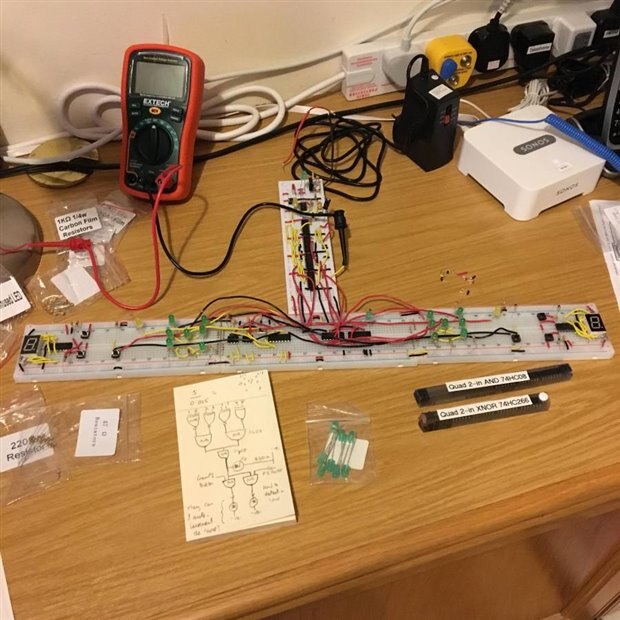

Really, you gotta breadboard, right?
This is a logic-driven game of snap, but with dice rather than cards.  It uses a XNOR!  If I remember correctly, that sketch on the post-it was for detecting and determining a match on the two LED die, turning on a player's led if they pressed the button correctly before the other player (and not if they didn't.)  I'd post a circuit diagram but about 1/4 of this is Charles Platt's work not mine so I don't feel it would be right.  I just came across the photo today and thought it was quite impressive - I keep thinking of going back to it and actually building it up and encasing.  It actually drove one of my very first questions on Element14 - I'd used an open-drain XNOR and didn't understand why it wasn't working.

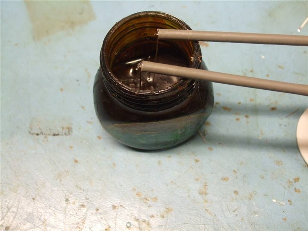

    And before anyone asks - that jar has 4 months to go before EOL !
    @ Christopher, not electrically conductive as we know it !

    cstanton over 6 years ago in reply to Andrew J
    I hear marmite is electrically conductive.

    It does seem that more and more chips are SMD only and the adaptors to use aren’t particularly cheap - I’ve thought it would be useful to cram them into spare PCB space when getting one manufactured.  At the time I created the above, breadboards, hook up wire and DIP chips/TH parts were all I had.  And a 9V/12V wall wart to drive them.
    I downloaded Microcap a week or so ago but haven’t had chance to play with it yet.  I find LTSpice “OK” but the UI leaves a lot to be desired on the mac.  There’s nothing intuitive about it so I’ve found features purely through serendipity than active knowledge.
    Where I am in my knowledge, I think breadboarding is useful for just trying things out, measuring them and playing around.  Even simple things like an RC circuit.
