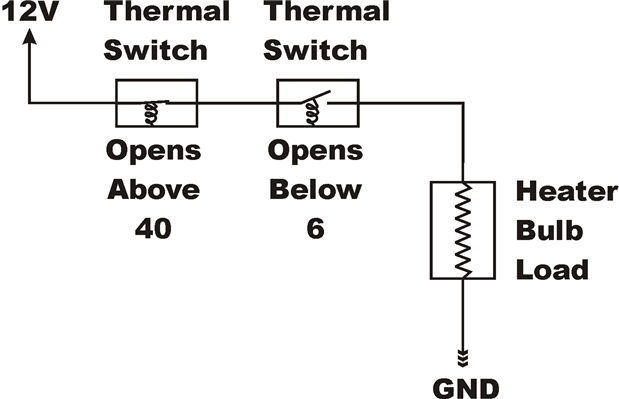

HI there
i whant to make something similar with a webasto sistem. Webasto is an auxiliary heating for cars. In my case i need 2 wather sensors and 2 relays or contacts. My sistem works like that ( in my imagination). I have from another car some incandescent plugs, that fits perfectly on heating pipes. From this plugs i have 2 wires, negative and positive for power and 2 relays for command. My point is: can i build, using arduino, one sistem that can start the plugs when is below 7 degres and stop them when are more than 40 degress ( celsius) ? What do i need?
THank you very much
    dougw over 11 years ago in reply to e14 Contributor
    You could use the thermal switches as inputs to an arduino which then needs to be programmed to control a transistor to drive your bulb, but you don't need an arduino or transistor or programming - just connect the switches like this to directly control your bulb to be on between 6 and 40:
    Could you simply use 2 bimetallic thermostat switches in series, one would open all temperatures above 40 and the other would open at all temperatures below 7 degrees - so both would only be closed between 7 and 40?
