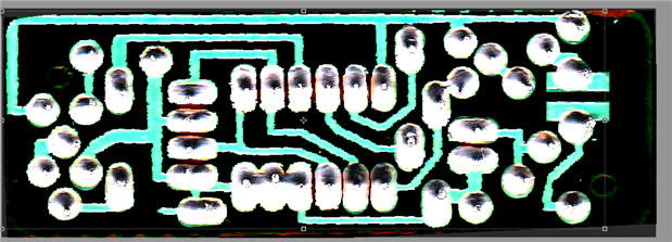

Here's the circuit board. Maybe you guys can understand this better.
Plus: Pin 1 of IC marked, and components are highlighted.

    A slightly more detailed view:
    It uses Holtek HT2811 chip.
    It uses two transistors to drive a speaker.
    Circuit schematics will be uploaded too.

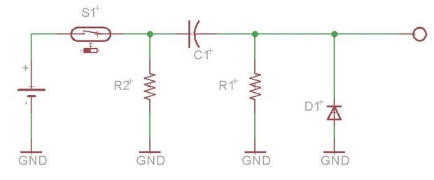

    It sounds like you want a directional switch that sends a single pulse if the door opens, but when it closes there is no pulse, just a reset.
    There are many ways to achieve this, even without chips .... one way is to use your reed switch like the circuit below:
    The switch is in the battery power wire so there is no power when the door is shut. When the door opens the switch closes and powers the circuit. On power up, the circuit generates a pulse with time constant R1C1.
    When the door closes nothing happens until switch 1 tuns off power to the circuit.
    R2 will bleed charge off the capacitor while the door is closed, getting ready for the next opening.
    D1 is just in case the ringer circuit can't take a 3 volt negative spike as the door closes, but if R2 is much bigger than R1, it is not needed.
    If you connect your ringer module power where R2 is and it takes some current continuously, then R2 is not needed.
    The circular terminal on the right is the pulse trigger for the ringer module.
    Doug

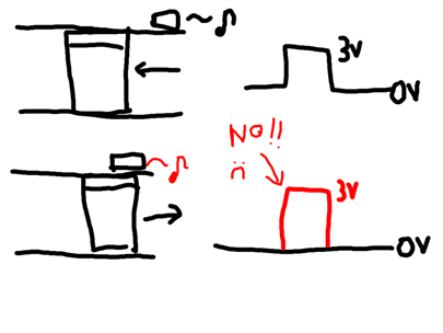

    Um, that doesn't work because...
    1. It will still ring more than once.
    2. The switch will activate twice - While opening and while closing.
    Looks like I have bad explanation.
    Look at the handy(?) picture below for the info.
    Explanation:
    1. The door opens - The bell rings as 3V pulse is being sent to the circuit.
    2. The door is opened - The bell stops ringing as there is no pulse sent.
    3. The door is closing - The circuit we are trying to build prevents the bell from ringing, as it only triggers once.
    4. The door is closed - The circuit shuts down and resets. It does not send pulse to the bell.
    Pseudo-code:
    IF door=open THEN power=1 AND pulse=1 AND reset=0 THEN pulse=0
    THEN wait until door=closed
    IF door=closed THEN power=0 AND reset=1 AND pulse=0
    ELSE power=0 AND reset=1 AND pulse=0
    End if
