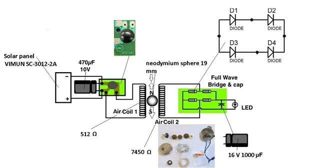

  • st1
    0 st1 over 7 years ago in reply to michaelkellett
    Hello !
    My proposal is to start building first an electric motor which will run under low voltage and current. It will work 100 % because I build it ( it is my creation ).
    I have powered the electric  motor with a single Vimun Sc 3012  tiny solar panel and I managed to start it in the artificial light, using only 1,25 V and 0.054 ma....
    Here is the motor :
    Then you will transform it in a generator (AC or DC )
    There is no converter, step up booster, joule thief, etc to start at the mentioned input ( 1,25 V and 0.054 ma )
    Increasing the voltage and current ( using a larger solar panel you will probably obtain what you are looking for  )
    Here you will find all the construction details
    https://www.instructables.com/id/DC-Generator-Powered-With-a-Single-Mini-Solar-Pane/
    I used a led from a lamp scanner which can light blue, green and red ( depending pin connection )
    Best regards ST
    The motor starts without help :
