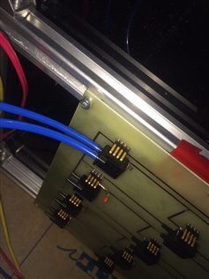

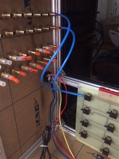

    0 e14 Contributor over 10 years ago
    Dear Friends
    thanks for your helps, your answer inspired me to solving this problem.
    i use a 4.7Kohm with 1% accuracy resistor but my problem not solved, so i decide to connect the tubes to sensor directly (I used to use Pneumatic connector for connecting tubes to sensor) and after that i saw it's worked. all the sensor shows same pressure.)
    i think because these sensors are ultra-Low pressure sensors (-1250/+1250 Pa) using usual pneumatic connection is not a good Idea.
    I learn a lot of your answers and thanks so Much for your answers and your time
    Best Regards

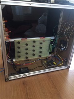

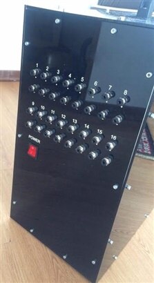

    Dear John, Michael and Douglas
    thanks for your quick reply
    the below picture shows my device, sensors and board
    let me answer your question one by one:
    1) are you using the correct voltage for the sensor (they do 5V and 3.3V parts)
         I use adjustable -+5 Vdc and set this power supply on 4.99V
    2) is the load > 5k
        dear Michael and Douglas, I don't use any resistance on pin 2
    3) have some been damaged - the damage pressure for a 5"H2O device is only 15" which is  a very low pressure.
        I use this sensor in a low speed wind tunnel (the MAX speed is around 45 m/s and it is equal to  1113.7 Pa), so I don't think sensors damaged
    4) Capacitor
         I use one 100nF before any Vss pin of each sensor

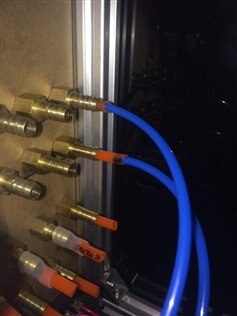

    do you think the problem may be caused for the way i connect sensor to pneumatic connector? (see below picture)
    actually I am a mechanical engineering graduate and not very familiar with electronic details, can i use a 10 Kohm resistor? and do I use this resistor on output (Pin 2)
