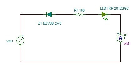

Hi everyone,
I'm rather new to electronics but would love to be able to work on projects at home! (now I only do electronics at school)
As a first project, I would love to convert an old Power Supply Unit into a power bench!
I read that PSU have a line called Power Good, which outputs 5V if the PSU is working correctly. I thought it would be cool to connect an LED to this line, so I could see if everything is OK!
For this I first thought of a simple LED+resistor, but then I figured this would make the LED emit light (less bright) even when there is eg. 3V on the line.
So I was thinking of a simple circuit with a zener diode with a breakdown voltage of 5V, but I'm not sure whether this would work as expected...
Since I pay for the components myself, I wanted to be sure this would work, before buying everything!
Can anyone tell me if this idea would work, and if not how to do it otherwise? I've looked on the internet and the main solution I find is with a comparator. I cannot use this because if the PG Line is wrong, I cannot know if the 5V line of the PSU is actually 5V...
What I want is an easy little circuit that has a LED emit light when there is 5V and not emit light when there is no 5V. (doesn't have to be completely exact) As far as I have found, this power good line varies between 0-5V (does not go higher).
Thanksfor your help!
Schematic of my idea:

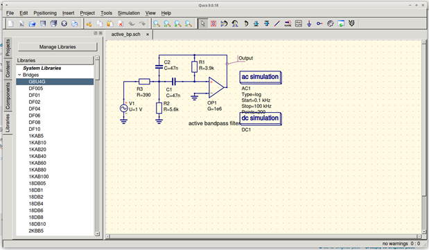

    0 e14 Contributor over 10 years ago in reply to e14 Contributor
    While TINA-TI seems to work nicely on top of wine for Linux users, I also found a different package, Qucs, which runs natively on Linux (at least, Intel/AMD).  This might eventually be a better fit for the SoCs like RPi since it would probably use less resources.  I am looking through their circuit libraries with the tool on Xubuntu:
    Go here if you are interested (executables and source code): http://qucs.sourceforge.net/

    0 e14 Contributor over 10 years ago in reply to jc2048
    For Linux desktop users, just install the wine package first.  Then, you can install and run TINA-TI as if it were a Windows desktop.  Note that I tested on a Xubuntu desktop system.  If I had a RPi Raspbian desktop, I'd try it there too but I am running OpenELEC.

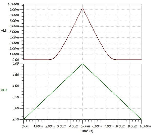

    0 jc2048 over 10 years ago in reply to 0phoff
    "It seems I was over-complicating things in my head!"
    But that's good. It lead to you asking questions, forming a specification for what you wanted to do, and then looking for a means to do it. You are learning to be an engineer.
    Your second circuit with the zener wouldn't work as you've drawn it. The zener doesn't allow current to flow until the voltage reaches 5V, so with only 5V as the source it never starts to conduct. If you make the zener about 2V, then you've got 2V for the zener, 2V for the LED and about 1V for the resistor. Current would start to flow when the input got up to 4V, and the brightness would then steadily increase as the voltage went to 5V [the brightness of an LED is proportional to the current].
    Here's what it looks like in a simulation with a 2V zener. I've got the input (VG1 - a voltage generator) ramping up from 2.5V to 5V and then back down again. You can see the current (measured by AM1 - an ammeter) which flows through the LED start to increase just below 4V. The peak current you can adjust with the resistor (a lot of LEDS have reasonable brightness at just a few milliamps, so don't feel you have to drive it at 20mA)
    If you think about it for a moment, you'll see that instead of the zener you could use a second LED. (One of the great things about designing is that there are always several ways to do things.) Wouldn't make sense for a commercial design, but a quick fix if the only components you have are LEDs and resistors.
    When I said "you've got 2V for the zener, 2V for the LED and about 1V for the resistor," I was informally giving you one of Kirchhoffs laws. If you don't mind a bit of theory, have a look at
