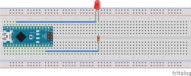

Arduino nano
e14 Contributor
Hi...!
     Now, I am using Arduino nano and facing with a problem. When I run a program, the Arduino nano stop working after 19 second and it rework after 5 second. So, please share me how to solve this problem. Thank you.
    0 e14 Contributor over 10 years ago
    Thank you Nico!
         I have found a problem as you said me. It caused from power source.
    And thanks again for Blink program.
    And thanks too to everyone who replied on comment.imageimageimage
  • ntewinkel
    0 ntewinkel over 10 years ago in reply to e14 Contributor
    ps, interesting way of blinking the LED. Doesn't block the main thread that way image
    For testing, maybe try the more basic form of Blink?
    (From Arduino IDE - File - Examples - Basic - Blink)
    // the setup function runs once when you press reset or power the board
    void setup() {
      // initialize digital pin 13 as an output.
      pinMode(13, OUTPUT);
    // the loop function runs over and over again forever
    void loop() {
      digitalWrite(13, HIGH);   // turn the LED on (HIGH is the voltage level)
      delay(1000);              // wait for a second
      digitalWrite(13, LOW);    // turn the LED off by making the voltage LOW
    -Nico
  • ntewinkel
    I have a feeling it's a problem with the board, or maybe a problem with the power source.
    The blink example should run as long as it's plugged in.
    If you have a second board, try using that to see if all is fine there.
    Or, try powering the board using something else - maybe a cell phone charger if you have one.
    -Nico
    • Reject Answer
    Honestly, I am at beginner level. So  I tested with two simple LED codes.
    The first one is
    class Flasher
      int ledPin;
      long OnTime;
      long OffTime;
      int ledState;
      unsigned long previousMillis;
      public:
      Flasher(int pin, long on, long off)
        ledPin = pin;
        pinMode(ledPin,OUTPUT);
        OnTime = on;
        OffTime = off;
        ledState = LOW;
        previousMillis = 0;
      void Update()
        unsigned long currentMillis = millis();
        if((ledState == HIGH) && (currentMillis-previousMillis>=OnTime))
          ledState = LOW;
          previousMillis = currentMillis;
          digitalWrite(ledPin,ledState);
        else if ((ledState == LOW) && (currentMillis-previousMillis>=OffTime))
          ledState = HIGH;
        Flasher led1(9,100,150);
      void setup()
      void loop()
        led1.Update();
    And the second is
    void setup()
    pinMode(9,OUTPUT);
    void loop()
    digitalWrite(9,HIGH);
    Thank you for your help.
    0 DAB over 10 years ago
    It sounds like you might have a cold solder joint or other defect.
    • Reject Answer
  • neilk
    0 neilk over 10 years ago in reply to e14 Contributor
    That doesn't really help. Please post your code and a schematic if you want help.
    I used blink example code from arduino.
    And I also gave HIGH to pin 13 for limitless time without delay.
  • gadget.iom
    0 gadget.iom over 10 years ago in reply to neilk
    Totally agree. We can't really help you without seeing your code and/or a schematic.
  • neilk
    Hi ayechan
    We obviously need to see your code before we have the remotest chance of helping you image
    Neil
    • Reject Answer
