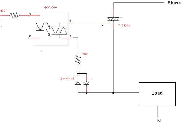

Hi All,
I'm working on replacing my aging and broken sprinkler controller, and found some open source software (OpenSprinkler) to run on a Raspberry Pi that handles the scheduling very nicely (plus it has an app for my phone).
With that software I'm able to control a couple of shift registers to turn LEDs on and off, simulating the sprinkling zones.
I'm not very familiar with TRIACs (read: not at all familiar, never used them before image), but recently I learned that the sprinkler valves use 24v AC and that TRIACs would be a good way to switch them, with relays generally being rather big once you get 16 of them lined up, and regular power transistors only being good for DC.
I bought some BRT12H "non-zero crossing" opto-isolating TRIACs (datasheet: http://www.vishay.com/docs/83689/83689.pdf), because they seemed to meet the desirements of opto-isolating and AC for 250mA.
I hooked them up (with 220ohm resistors from shift registers to TRIACs), and it all looked promising when I turned the first zone on (sprinklers worked, yay!), but then it wouldn't shut off (sprinklers still working, not yay!). It only shuts off if I remove the 24v power momentarily.
I've done some Googling around but have not yet found any solution, and to be honest it's not making a whole lot of sense to me (yet... hopefully yet).
I did find out that TRIACs (in general?) need to cross zero (volts?) to turn off. I'm not sure what this "non-zero crossing" bit means but I have a nagging suspicion that it's a key part of the issue.
Should I have bought "zero crossing" TRIACs instead?
Can anyone help shed some light?  ...and hopefully also shed a solution image

  • D_Hersey
    0 D_Hersey over 10 years ago
    Sometimes, snubbers are needed with relays as well.  The inductive spike can pit or weld the contacts.
    • Reject Answer
  • ntewinkel
    0 ntewinkel over 10 years ago in reply to D_Hersey
    Aww man! There's no getting away from this lesson on snubbers, is there?
    I was having no luck with the R(620ish)-C(10nF) attempt - the valve stayed on, so I'll have to revisit that math. I've also set it up on a separate little breadboard for easy testing.
    So to make sure I'm heading towards the right path, is the snubber designed based on the inductive load then (in my case the sprinkler valve) ? (as opposed to the triac ratings?)
    And what is the best way to figure out the values? My multimeter can check for inductance of the sprinkler valve coil. And I can get the Amps used. Or can it all be based on the general values that most 24v sprinkler valves have?
    Thanks,
    -Nico
  • jc2048
    0 jc2048 over 10 years ago in reply to ntewinkel
    "And what is the best way to figure out the values?"
    Iteration. Increase the capacitor value and decrease the resistor value a bit and try again. But when you get down to a resistor value of 100 ohms and up to a capacitance value of 100nF, stop and have a think about whether the problem might be something else.
    What's going on is quite complicated and involves the coil, the snubber components and the triac. Modelling that lot is complicated. Changing a couple of values on a breadboard is easy.
    Could you tell us what the inductance and resistance of the solenoid are, as measured by your meter?

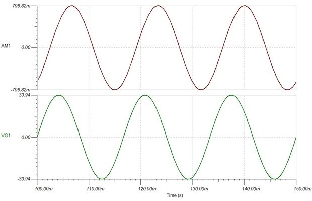

    The simulator is TI-TINA. It's a cut-down version of a commercial offering which is given away for free by Texas Instruments.
    http://www.ti.com/tool/tina-ti
    The schematic capture is irritating - you draw the nets on, so it's very easy to get nets that don't join or bits that sit on top of each other. The simulation warns you if there are dangling connections, but you still have to go back and repair something the software should just get right.
    There is a reasonable range of library parts built in, which is good. It's good because importing component models is a bit of a pain [that's the case with any simulator - it isn't a deficiency of this particlar one].
    You could also try Linear Technology's offering
    http://www.linear.com/designtools/software/
    I tried this a long time back and it was very biassed to Linear's own devices [understandably], but perfectly useable. I really ought to give it another go because I'm sure they'll have developed it further in the meantime. [TI's offering is also biassed, but since their catalogue includes so many generic parts you don't really notice.]
    Since they are free, you could install both and see which you like using.
    I was being stupid about the solenoid; of course the inductance changes as the plunger moves because the magnetic circuit changes. Don't even know where you'd start to model that, though.
