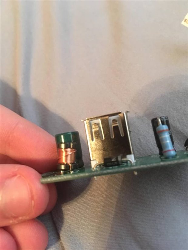

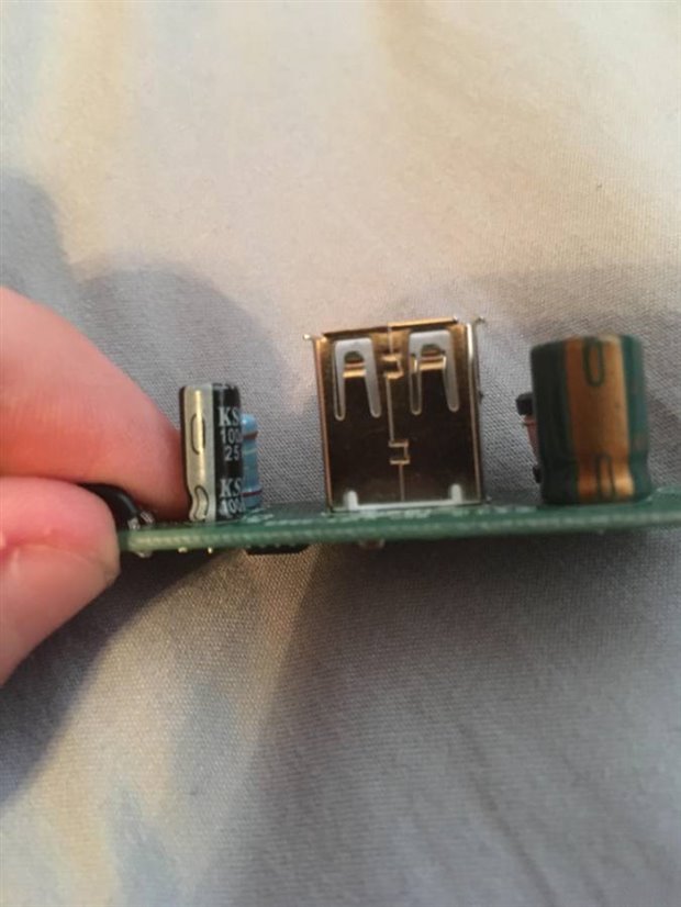

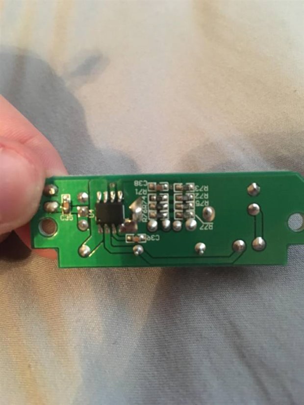

So I have this little chip here from a cigarette lighter psu, but there isn't a voltage regulator any where in it. If this is indeed a buck converter, that would explain the lack of a regulator, but I'm new to this kind of stuff, (I first got into it  while creating a project for school last year) so I would appreciate any help I can get.

    whoops. yea i meant  kohms. I found what I belive to be r1, its a .43 kohm and a 3.3 kohm in series, so if at all possible i want to try to only mess with r1.

    ok so I've located r1. its 1.2Ω. Im still working on r2. once i find that, ill plug it into that equation that Texas instruments has, and I'll replace r1. and issues in doing that?

    shabaz wrote:
    You didn't specify the reason for 4.7V, but if you're happy with "about 4.7V" then you could put a diode in series with the output.
    Yes if you only need approximately 4.7V then this is a good idea. If you use a schottky diode then the Vf of the diode should be low enough that you'll be around the 4.5-4.7V range depending on the exact device chosen and the current being drawn.

    well, the reason is I'm actually trying to make an adapter for my 3ds. There was an old gameboy advance charger that hooked into both the wall or a cigarette lighter. I plan on making one of these that is fine tuned for the 3ds, as it is VERY cheaply made and will break at a little over 5 volts (it normally wants 4.6)

    You didn't specify the reason for 4.7V, but if you're happy with "about 4.7V" then you could put a diode in series with the output. The output won't be accurate any more, but will be lower than 5V slightly (could vary to 4V or lower). For any accuracy you need to take the approach Rachael mentions with the resistors,but needs the steps mentioned (soldering capability, resistors purchased). If you're interested in this as a hobby, see this URL for lots of information: I Want to Do Electronics!  Where do I start?

    ...although I now know that I'm going to have to find someone to replace the surface mount resistors for me.
    Or use it as an excuse to invest in a decent soldering station! You don't have to spend huge amounts to get something adequate for starting out and it'll prove to be exceedingly useful time and time again if you continue to pursue electronics further image
