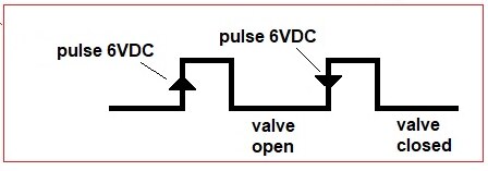

So here's the situ... I want to be able to remotely switch a hose pipe on, but the thing is, the system is fixed into my vehicle so the whole thing has to be portable and run off batteries. I have a remote switch that at the press of a button (on the remote) can momentarily (or it can be set to self lock also) connect the battery to the solenoid valve and switch it on but the valve needs the polarity to be reversed and pulsed to switch it off again. For love nor money can I figure out a way of doing this? My head is in a whirl from all the h-bridge... dpdt relays... flipflops... etc.... every time I research something it seems I need something else to make it work. (if that makes sense) I am lost.
In short what I want to do is: Press the button on the remote control once and it turn the water flow on, and press it again and the water turn off. Basically its a momentary push button input that alternates between a +6v output and a -6v output. If that is possible.

    Through the use of a magnet, the latching solenoid valves are bi-stable which allows them to stay in either state indefinitely without drawing any power. To shift the valve from one state to another, a short 25 millisecond DC voltage is applied to the coil. To shift the valve back, a reverse polarity pulse is applied. Result is an extremely low power usage and negligible valve coil temperature rise, subsequently providing very long battery life.

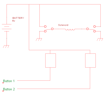

    0 mcb1 over 8 years ago in reply to sim.parkin
    can't i just hook one relay up to the battery and hook the other one in the opposite polarity?
    Two SPDT relays driven from two buttons would work just as well.
    You can purchase dual relays from many asian suppliers, and most are 5v but will handle 6v for a short period.
    Most of the relays are set for ground to operate (Active LOW), but some allow either.
    You will need to check how long the remote receiver provides the pulse for.
    A simple LED (and resistor) will tell you, and if it's too long then it might still require some magic electronics.
    • Reject Answer
  • sim.parkin
    0 sim.parkin over 8 years ago in reply to mcb1
    Hi Mark.
    Thank you very much for your input there. I did quite a bit of research on h bridges. I have been thinking about your solution and it appeals because i can just buy a board 'off the shelf' so to speak. But if i have a two button remote control can't i just hook one relay up to the battery and hook the other one in the opposite polarity? I think this is what you mention at the end of your post. I cant really see the advantage of using the h bridge because it has to have two inputs anyway, but if I missed something (quite probable) please let me know.
    Thanks again for your help and advise! image
    Best regards.
    Simon.

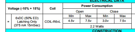

    6v / 9Ω is 667ma is that right?
    Correct.
    The reality is that an inductive coil (motor/solenoid) will draw more as it gets powered up due to the magnetic effect trying to resist change.
    For smaller inductances 1.5 to 2 times is a general figure, but that is only for a short time, while the constant drain is as you calculated above ... not that they are designed to be on all time.
    In reality the length of time you are going to apply power onto the solenoid is nothing.
    The standby power for the receiver is likely to be greater over 24hrs than the time to energise/de-energise the solenoid.

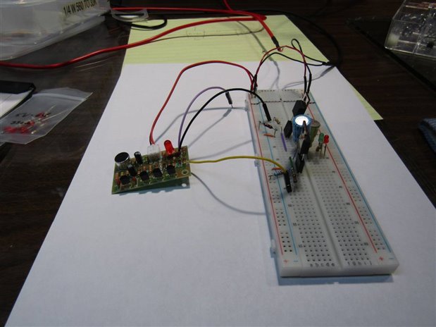

    0 jw0752 over 8 years ago
    Hi Simon,

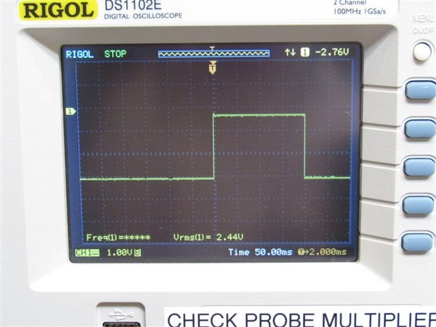

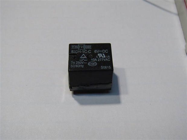

    I was back in the shop playing with this idea. I have changed the capacitors to 1000 uF and I have changed  R10 and R11 to 390 ohms. I hooked up a small 6 volt DC relay with a 100 ohm coil to see if it could be actuated. Here is the relay:
    I put my analog ohmmeter across the NO contacts in parallel with my scope probes. This should give me about 3 volts on the scope when the contacts are open and zero volts when they close. Here is the scope image of the relays contacts.
    As you can see the pulse was strong enough to close the relay contacts for 200 mSec. This relay is fairly easy to actuate so I am not sure that it is a good model for your solenoid. You will have to do some experimentation. I am calculating that we had a peak of about 70 mA to the relay coil and dropping from there as the capacitor charged.

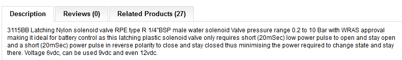

    After shopping around, I found this solenoid valve and bought it but it needs a longer pulse I notice. https://www.ebay.co.uk/itm/DC6V-1-2-Electric-Solenoid-Valve-Water-Fuel-Electromagnetic-Valve-White/122324613817?ssPageNa…  Can you help me understand how to alter the circuit to its spec? I think I have to change the capacitors but possibly also something else? the ad doesn't give a current draw but am i right in saying we can get this from the coil resistance in ohms that is given? 6v / 9Ω is 667ma is that right? Possibly missing something.
