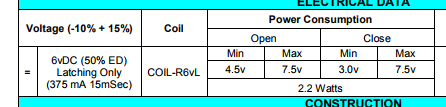

    The additional information was helpful and from this information in the data sheet:
    I have a little more confidence that my circuit can be made to work. Keep in mind you may have to experiment with the size of C3 and C4 as well as the value of R10 and R11. According to the Data sheet we need 375 mA for 15 mSec to actuate the solenoid.

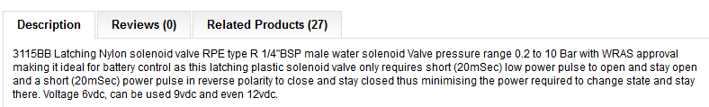

    After shopping around, I found this solenoid valve and bought it but it needs a longer pulse I notice. https://www.ebay.co.uk/itm/DC6V-1-2-Electric-Solenoid-Valve-Water-Fuel-Electromagnetic-Valve-White/122324613817?ssPageNa…  Can you help me understand how to alter the circuit to its spec? I think I have to change the capacitors but possibly also something else? the ad doesn't give a current draw but am i right in saying we can get this from the coil resistance in ohms that is given? 6v / 9Ω is 667ma is that right? Possibly missing something.

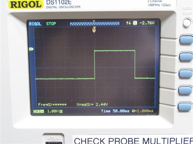

    I was back in the shop playing with this idea. I have changed the capacitors to 1000 uF and I have changed  R10 and R11 to 390 ohms. I hooked up a small 6 volt DC relay with a 100 ohm coil to see if it could be actuated. Here is the relay:
    I put my analog ohmmeter across the NO contacts in parallel with my scope probes. This should give me about 3 volts on the scope when the contacts are open and zero volts when they close. Here is the scope image of the relays contacts.
    As you can see the pulse was strong enough to close the relay contacts for 200 mSec. This relay is fairly easy to actuate so I am not sure that it is a good model for your solenoid. You will have to do some experimentation. I am calculating that we had a peak of about 70 mA to the relay coil and dropping from there as the capacitor charged.

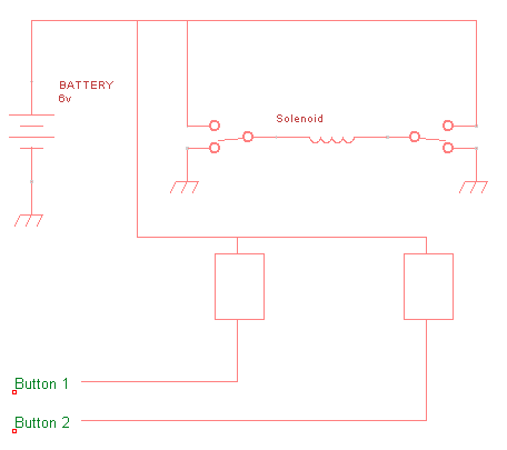

    Thank you very much for your input there. I did quite a bit of research on h bridges. I have been thinking about your solution and it appeals because i can just buy a board 'off the shelf' so to speak. But if i have a two button remote control can't i just hook one relay up to the battery and hook the other one in the opposite polarity? I think this is what you mention at the end of your post. I cant really see the advantage of using the h bridge because it has to have two inputs anyway, but if I missed something (quite probable) please let me know.

    0 mcb1 over 7 years ago in reply to sim.parkin
    Two SPDT relays driven from two buttons would work just as well.
    You can purchase dual relays from many asian suppliers, and most are 5v but will handle 6v for a short period.
    Most of the relays are set for ground to operate (Active LOW), but some allow either.
    You will need to check how long the remote receiver provides the pulse for.
    A simple LED (and resistor) will tell you, and if it's too long then it might still require some magic electronics.
