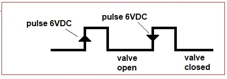

So here's the situ... I want to be able to remotely switch a hose pipe on, but the thing is, the system is fixed into my vehicle so the whole thing has to be portable and run off batteries. I have a remote switch that at the press of a button (on the remote) can momentarily (or it can be set to self lock also) connect the battery to the solenoid valve and switch it on but the valve needs the polarity to be reversed and pulsed to switch it off again. For love nor money can I figure out a way of doing this? My head is in a whirl from all the h-bridge... dpdt relays... flipflops... etc.... every time I research something it seems I need something else to make it work. (if that makes sense) I am lost.
In short what I want to do is: Press the button on the remote control once and it turn the water flow on, and press it again and the water turn off. Basically its a momentary push button input that alternates between a +6v output and a -6v output. If that is possible.
I want to use this latching type relay because you can get low power ones of this type, but they also save battery power by only requiring a pulse of electricity to change state, rather than energising a coil for longer periods of time. Oh and I also want to avoid using microcontrollers if possible because I can't code.

    Hi Simon, The additional information was helpful and from this information in the data sheet: I have a little more confidence that my circuit can be made to work. Keep in mind you may have to experiment…

    Hi Simon, I may have a possible solution for you. This is a bistable or Flip flop that I was playing with the other day. This one is triggered by sound but it could just as easily be triggered with a momentary…

    Through the use of a magnet, the latching solenoid valves are bi-stable which allows them to stay in either state indefinitely without drawing any power. To shift the valve from one state to another, a short 25 millisecond DC voltage is applied to the coil. To shift the valve back, a reverse polarity pulse is applied. Result is an extremely low power usage and negligible valve coil temperature rise, subsequently providing very long battery life.
