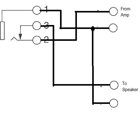

I am newer to DIY electronics and I am working on a project. I have a project that I am building and I am stuck on this one part. I have an Adafruit Mono 2.5W Class D Audio Amplifier - PAM8302 and I want to bring teh Speaker out to another board that will have a Speaker and headphone jack on it. I want to wire it so when the headphones are plugged in the speaker is off and the sound comes through the headphones but when unplugged the sound comes out the speaker. Below is a basic mock up of what I want and I am just stuck on how to accomplish it.
I have tried to Google the answer but have had no luck. Orange dots are the thru hole solder points for each component any help will be appreciated.
MockUp
    0 genebren over 8 years ago
    Jacob,
    The connections are really quite simple.  The diagram below is how it should work.  Keep in mind that the pin-out on the headphone jack will need to match the part that you are using.
    Good luck,
    Gene

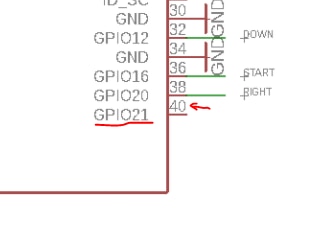

    Hi Jacob,
    I think your misinterpreting that table as only GPIO0-27 are available by way of the 40 pin header, its a bit confusing but there are two ways of referencing the pins on the 40 pin header.  If you look at the schematic symbol you have posted each pin has a pin number and a description associated to it, pin 40 is in fact GPIO 21.
    Which if we look at your table you have linked to isn't capable of being used for PWM
    After looking the link you posted I get the feeling the guy used a USB audio device rather then the IO, but if you don't need two sets of triggers you could use GPIO 18 (pin 12) and wire you amplifier to this pin and ground.  You'll need to make some software modification, according to Step 7 of the projects setup (https://github.com/32teeth/Gameboy-Zero-Kickstarter/blob/master/INSTALL.md ) you have to edit the control setup anyways.  You'll want to free up gpio 18, so delete the following two lines from the config file
    A 18  # Left shoulder button
    OR
    change
    to
    A 21  # Left shoulder button
    but doing this will require you to lift the tact switch from being connected to GPIO_18 and run a wire from the tact switch to the GPIO_21.
    Hope this helps
    Chris

    0 jlusco over 8 years ago in reply to shabaz
    I thought about the schematic right after I asked. I took a look and now I am confused there are a hand full of pins not used but from the link you provided and looking at the GPIO Alt functions the only PWM pin free is 40. The designer has a PWN board as well that looks a lot like the circuit in the Pi Zero Adafruit page you provided. So Pins 3,5,7,8,16,27,28, and 40 are all free if I am reading it correctly but based on what I see here https://elinux.org/RPi_BCM2835_GPIOs only Pin 40 is PWM and it looks like you have to use a PWM1 and PWM0 pin am I understanding this correctly. I have also reached out to teh Designer to see how he suggests wiring his PWM board to the device.

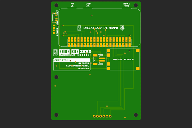

    So I am building a Gameboyzero (Link Below) and you mount the Raspberry Pi Zero W onto the PCB. I am not sure if I can use the GPIO PWM. Here is an image with the pins numbered maybe you can tell if I can do what I want to this way.
    https://www.tindie.com/products/thirtytwoteeth/game-boy-zero-handheld-edition/

    0 shabaz over 8 years ago in reply to jlusco
    Hi Jacob,
    It's not possible in the way you mention, without additional hardware (a USB sound card effectively). Otherwise GPIO can be used.
    If you don't want to use GPIO connections, then a USB sound card is needed.
    If you do eventually decide to use GPIO, see here for the circuit you need (in additional to the amplifier which you have already got).
    https://learn.adafruit.com/introducing-the-raspberry-pi-zero/audio-outputs
    Or you could connect a digital audio card to the GPIO pins. But it uses GPIO pins.
