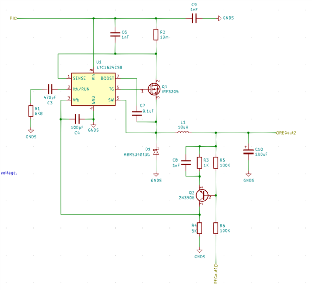

I presume this is possible with power off, looking for resistance between drain and source?
I'm pretty sure I've killed it - resistance is 0.33Ohms between these two pins image  Out of circuit, on a good one, it is > 13MOhms.  Looking at my circuit, I've solder the Schottky Rectifier the wrong way around - cathode to ground imageimageimage  Pretty sure that won't have done the Mosfet any good, it was too hot to touch.  Can't believe I've been so stupid - by good luck, rather than management, the other Schottky I have in the circuit (not shown below) is the right way around.

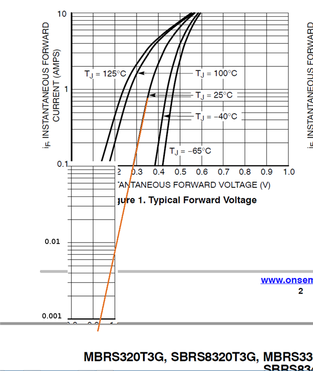

Is there a way of testing the Schottky rectifier in-circuit - I've tried it and the DMM 'beeps' as it detects a normal junction; measures 0.159v and 0.579V depending upon orientation of test leads?  Just to clarify - in the schematic below you can see how the Schottky rectifier should be - however, as I say, it's actually reversed and I don't know if that might affect readings. So, with the COM lead to the cathode and test (red) lead to anode it reads 0.159v; with the COM lead to the anode and test (red) lead to cathode it reads 0.579V.  I can test one out of circuit and I get 0.157V and OL respectively.  I think that indicates it is ok but in circuit it isn't reading as OL: I have to remove it to swap it around in any case so would the advice be to chuck it and use a new one?
I'm really hoping I can get it off with wick and an iron and without damaging the board; ditto the Mosfet. I really don't want to lump out for a rework station.
Is there likely to be damage to other components down stream?  Any tips for testing components without removing them from the circuit?
This is only part of the circuit but shows the relationship between the Mosfet and Schottky rectifier:

    Regarding the boost voltage, your output is designed for beyond 15V I think? (I can't recall). If so, then the design needs a zener diode perhaps, across the gate-source of the MOSFET, because most devices don't tolerate more than 20V or 30V for the gate voltage. You'll also need a series resistor for the gate (i.e. disconnect pin 6 [TG] pin of the IC, and put the resistor in series there), maybe 10 ohm. The zener could be a 10V one, which would still switch on the device very well, and leave safety margin. Unless I've misunderstood, it seems misleading that the datasheet does not mention this, since the IC is designed for up to 30V output.
    Also, it's hard to know if the control system you've got to adjust voltage, is having an effect or not. I was wondering, do you have a spare extra chip? If so, it could be worth just prototyping on some scrap board (or on another of the same PCB if you've got some spare) just that IC and parts in a conventional layout (i.e. using a potential divider pair of resistors to set a voltage), get that working confirmed at (say) a high voltage that you expect the design to be able to handle, and then try to add the control circuitry.
    Also, the part is from a distributor, right? (ebay parts are often fakes, that may or may not partially work. I've been burned by that in the past).

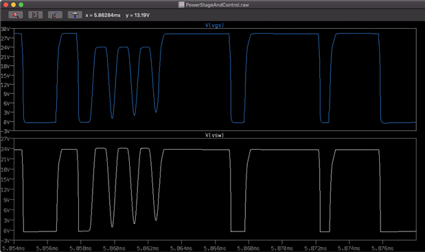

    When I say Vgs I actually mean the voltage on the output pin to the Mosfet gate, sorry.  But actually, I now understand this a bit better.  Voltage on the source is 17.4v, so it's ok for Gate voltage to be around 30.  I think you finally got it drummed in me image
  • jc2048
    0 jc2048 over 7 years ago in reply to Andrew J

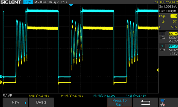

    Vgs is the difference between the gate and the source. That's the difference between the blue trace and the yellow trace in the second picture. If you adjusted the traces so the gounds were together, you'd see where the MOSFET was off the two traces would be on top of each other (ie zero Vgs) and where it was on it was around 5V apart (5V Vgs). If you experiment with the maths functions, you could probably get the scope to display that nicely for you.
    The switch node ringing looks horrible, but isn't seen by the gate. At that stage the Vgs looks like it's still zero. The ringing comes to an end when the top MOSFET turns on again.
    I'm not too sure what it's doing, though. When I spoke previously of ringing, I was refering to the other edge where the top MOSFET turns off and the inductor takes the switch node voltage down quickly until the Schottky turns on. Here it looks like the energy in the coil is used up early. That might be the inductor value being too low or the coil saturating or maybe the business with the feedback voltage. Why isn't it up around whatever the internal reference voltage is?

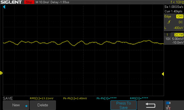

    I understand it isn't easy, and to be honest I wouldn't expect you to debug it but I do appreciate your input/insights.  I changed the Mosfet this morning but it's made little difference.  For information, I've captured three images:
    Switching noise at the terminals (equivalent to the above image) - frequency has changed drastically:

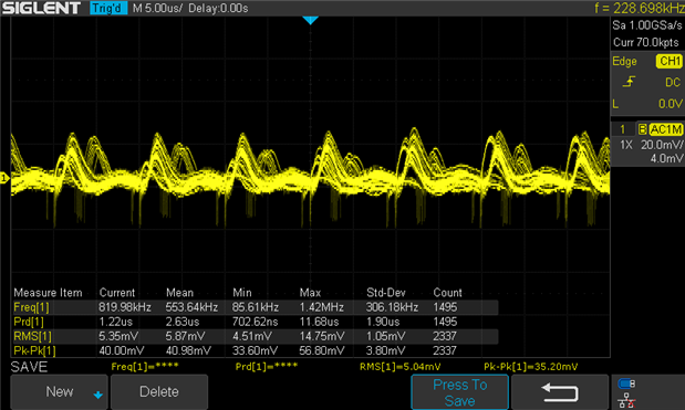

    I've also captured the waveforms at Gate (channel 3, cyan) and SW (channel 1, yellow).  Gate is being driven 5v above SW but it still looks like the switching frequency is 100kHz, there's a fair bit of ringing.  But mostly, 32V pk-pk is way above the allowable gate voltage for the Mosfet, even RMS is too high.  I find the behaviour of the part a bit strange/confusing: gate is driven to SW + 5.6V; SW is driven from 0V to Vin as dictated by the Schottky Rectifier which swings 0v to Vin.  This part accepts Vin upto 36V but I'm providing 24.5V.  So the values follow that 24.5v but I only found one Mosfet with a gate voltage at 30v (actually, only one above 20v) that could drive >3A so it would seem 20v is very standard.
    Interestingly, this is what LT Spice has to say:
    (sorry, not a great picture)  Gate is blue; Sw is white.  Gate is showing pk-pk of 28.744V and RMS 22.302; SW is showing pk-pk of 24.10v and RMS 19.104.
    Here's an image of voltage at the feedback pin.  I can't get the volts/div any lower and at a smaller timebase it 'looks' sinusoidal but that is disguising what it really looks like:
    I have tried a simpler schematic in LT Spice that works (more in line with the data sheet, without the transistor in the feedback); changing some of the capacitor values removes a lot of current ripple from the inductor - gate, sw and feedback are a lot cleaner.  I'd have to gear myself up to repurchase parts and re-do PCBs to change it.  Or lump out for a re-work station of course.  Ultimately, I'm struggling to see, now, how this chip can provide an output voltage of 15V when that would require a Vin of circa 18V but which would then drive the Gate voltage up to > 20V (albeit in 3.4us pulses - actually that's at 24.5v Vin but you get the idea.)  The datasheet does have state it can drive upto 30V output in step-down configuration and I'm only asking for half that!

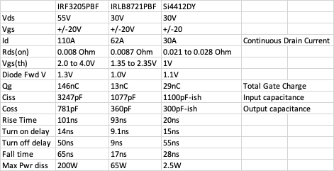

    I'm swapping the IRF3205 for an IRLB8721 as it seems a better fit based on parameters I think are important (but I'm not sure!)  Here's a comparison:
    You can see the IRL is very close to the Si (which is obsolete, not possible to get as old stock and surface mount only.)  The input capacitance is way down and the gate charge is much faster.  I've included the rise/fall/delay times for comparison but my understanding is they are based on a very specific circuit so unlikely to be more relevant than the gate charge.  It was difficult to find anything really as the parametric searching is limited on Farnell and CPC - a lot better on Digikey and RS.  I didn't mean to imply anything by mentioning the gate charge above, hope you didn't take offence - I was just doing a fair bit of reading based on your earlier helpful comments.
    Once I have a better fit Mosfet installed, I'll test and take measurements.  I suppose my first question about the switching ripple was whether that was the type of thing you were talking about originally in respect to the Mosfet choice: I've got no past experience to judge!

    You are right, I should talk about the gate charge. (That's the kind of sloppy stuff you get for talking to someone just helping out rather than a power expert. Perhaps someone could hurry up and write 'MOSFET Essentials'.) But there's a certain amount of correlation between the two.
    I still feel uncomfortable about the IRF3205 though obviously it's your choice what you use. Have a look at the curves on each datasheet and see what you think. Remember you've only got 5V of drive, so the IRF part is still in its linear region, whereas the SI part has the channel fully open by then.

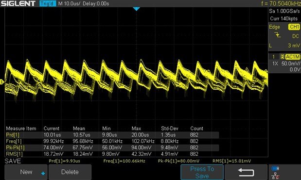

    No problem Jon.  The frequency of the LTC1624 is 200kHz and I presumed the 100kHz frequency was in some way related to that.  That image was measured at the output PCB terminal with a 10 Ohm load attached.  The Schottky is measuring a temperature rise of approx 12C after 1 hour of continual running at 15.5V / 1.5A so not bad I think.  In fact, none of the components are over heating.  In part 11 of my blog on this I have described a lot more test results.
    The LTSpice simulation runs perfectly although having said that I don't know how to model the noise/ripple with the tool - I've tried but couldn't get anything useful out of it.  Expanding the simulation output waveform (essentially, the DC output), there is approximately 2mA of ripple: look at the steady state measurement I put up in Part 11 and it looks like that!
    The noise is the killer but also its not right with a 5 Ohm load (but ok with no load and ok with a 1000 Ohm load.)  My assumption was that it was choice of top side Mosfet.  The input capacitance is way over the amount allowed for a 0.1uF boost capacitor (by nearly 2x) and the Gate Charge is really high as well.  In fairness, I may be sounding like I know more than I do with that but my understanding is that gate charge is a better indicator of how fast the Mosfet can operate.

    So that's a screenshot from your new oscilloscope. Looks very good, though the automated measurements are getting thrown a bit over the frequency. It's giving you a much better picture of what's going on than the multimeter ever could. And you're good at using it already [I had a hunch you might be].
    Presumably, that 100kHz is the switching frequency and you're looking at the effect of the current ripple on the ESR of the output capacitor and the discharge to the load [the first, steep downward part is the ESR and the further, shallower slope is the capacitor discharge]. Is that with full load on the output? How does that compare with what your simulation was showing?
    What I was fussing over was the internal bottom MOSFET that momentarily gives the Schottky a helping hand [to clamp any subsequent oscillation from the LC circuit at the switching node] because it wasn't obvious from a quick, cursory look at the datasheet how it's timed after the external top MOSFET goes off. So if you delay the top FET, the bottom one might get it [if the two were on at the same time, it's the internal one that would die and possibly take out the complete controller]. But the chip designers are used to the things us circuit designers do, so there's probably plenty of leeway.
