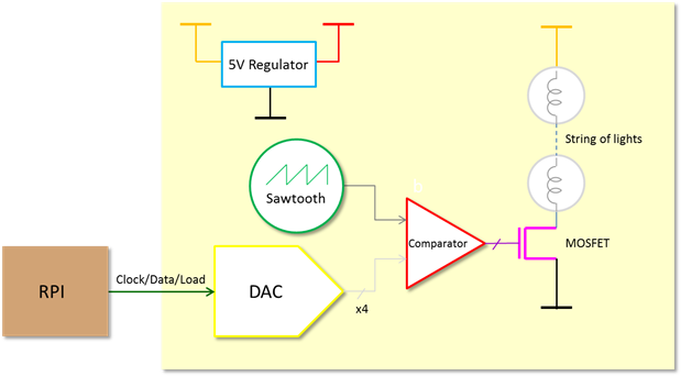

    PowerPoint is an option too. This diagram was done with it (showing connections between dev-boards for example):
    I like using PowerPoint, but I appreciate it is an acquired taste. it is useful for block diagrams too, to help explain the circuit before showing the schematic.
    If you're not into PP, then Visio is an alternative.

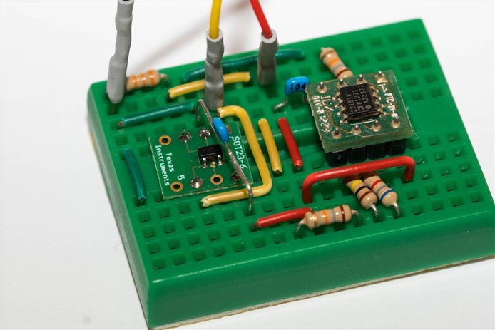

    Generally I'll just use a conventional schematic too (using EAGLE in my case, but there's plenty of options), and then try to have a detailed photo of the PCB or breadboard too.
    EDIT: One more thing, personally I feel high-res helps for everything : ) That block diagram above was drawn six years ago, but since I'd saved it in a high-res, it still looks readable without needing to zoom in heavily, on the more modern super-high-res monitors, despite having drawn the diagram on probably a 1024x768 screen 6 years ago. Just personal taste has changed since then though.. now I'll often use a white background for such things, and thicker lines and a larger font. Not everyone likes large file sizes perhaps, but I have to make a compromise somewhere, and if I have to make that choice then it will be on the side of readability.

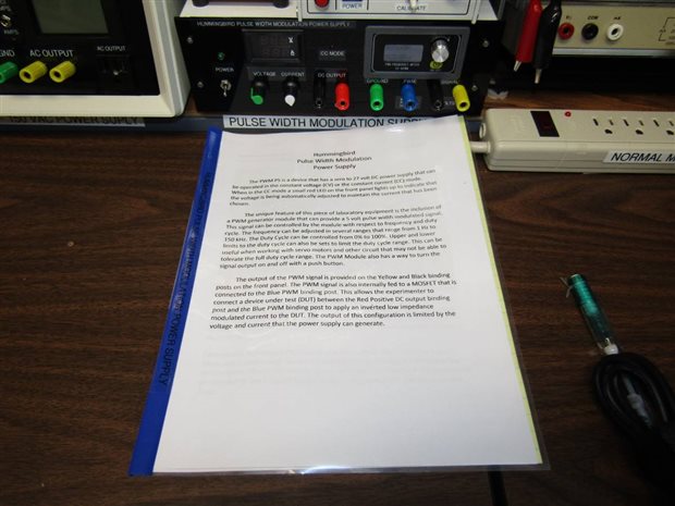

    Hi Brian,
    In addition to what I may place in a blog on a project I always make an owners / service manual to go along with each project. I find that even simple projects have a way of becoming difficult to understand if they have been sitting on the shelf for a couple years. The manual provides a progression of schematic revisions and notes on experiments that were necessary to complete the design. I also photograph the project as it is being built and include a gallery of photos in the manual. I have found that I always remember and need pictures that I did not take so don't hesitate to take more than you may need. The manuals are produced in report form as well as being stored on my shop data base. Here is an example of a build and the manual for it. As you can see they are very simple but very helpful should I ever need to service it.
    I really liked your question as the answers from the other members will provide some good ideas and resources for everyone.

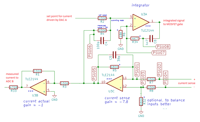

    For more permanent exercises, I use KiCad. I put comments on the schematic. When I want to document a selected part of the design, I printscreen the KiCad schematic, paste it in Paint, and erase the components and connections that aren’t relevant.
    Example:

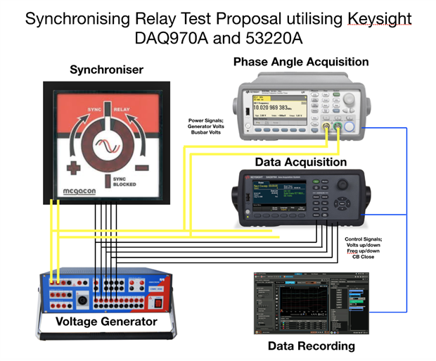

    I use KiCad for schematics and PCB layouts. For more electrical biased drawings I use a normal CAD package, TurboCAD, Visio and SmartDraw have all been used over the years.

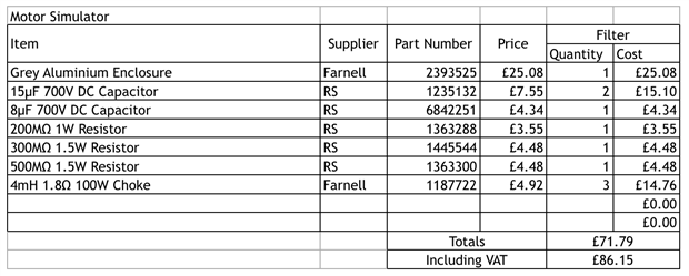

    Calculations are generally done in Excel. MathCAD is used for more complex calculations. All the test results for my insulation tester reviews are in Excel and then plotted using the graphing function as required. I also find Excel good for BOMs, but sometimes I use Word for this.
    Having seen what shabaz has created in Power Point, I too have started to use that to produce basic layouts.

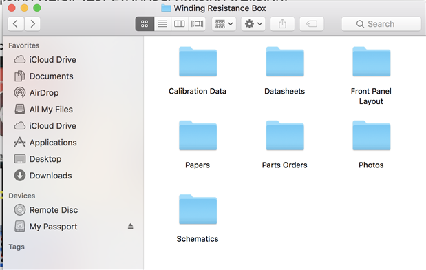

    I will either store the project as separate files in one folder on the computer, or if need be I will pull everything into a Word document, to create a more formal manual for it. I then usually index this and create as a PDF as I refer to read documents in a PDF viewer instead of Word.
    Along with all of the files I have created, I will store manufacturer's data sheets, parts orders, emails and subject information in the same folder, so I try and end up with everything for the project in one location.
