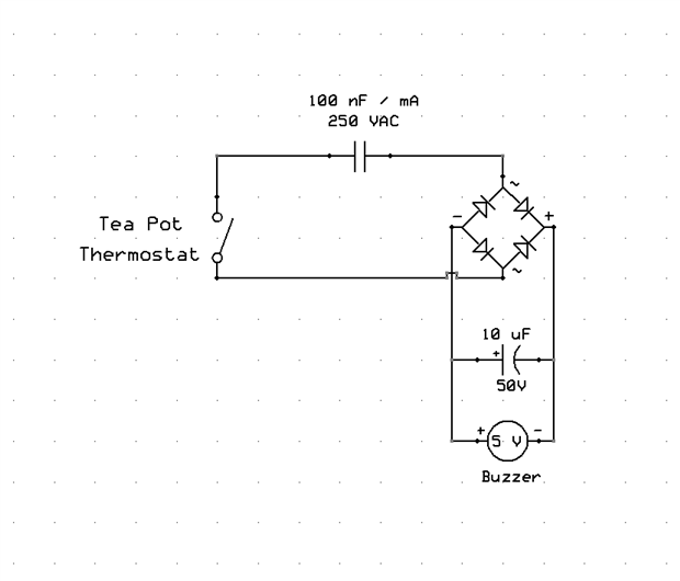

I have an Itaki cooking lunch box, which is a tiny Japanese 200W steamer, made to take your lunch to work and heat it.
Its operation is pretty simple: It has a heating element, switch, pilot light, and temperature-controlled switch. You put water it in, and when the water boils off, the temperature rises and turns the heating element off.
The trouble is that there is no audible alert when it is done - you have to set a timer and keep checking the pilot light.
I want to add a buzzer that will make sound when it's done cooking. My plan is to take the voltage that will be across the temperature-controlled switch. I'll have a capacitor in series to drop the voltage, and a full-wave rectifier to make DC to power a 5v or 12v buzzer.

    0 jw0752 over 6 years ago
    Hi Steven,
    Your idea interested me so I breadboarded it on my bench. I used your description of a power circuit as shown in this schematic:
    I found a small sonalert that sounds a lot like the steam whistle of an old fashion teapot. At 5 volts it drew 20 mA so using the Xc formula I calculated that I would need about 500 nF in series with the bridge rectifier in order to supply a comparable current from my 115 V 60 Hz line voltage. In the schematic above, the label on the capacitor should read 100 nF / 4 mA. You will have to measure the current draw at operational voltage for the sonalert that you choose. It might be best to choose one that has a steady sound as this circuit is designed assuming a pretty constant load and the circuit will attempt to deliver a current of 20 mA by increasing the voltage across the buzzer. If you do decide to use a sonalert that doesn't present a constant load to the line you could put a zener diode across the buzzer to keep the voltage from damaging it.
    The challenge will be to get all the components into a safe enclosure since you are dealing with line voltages and fatal shock hazards. Here is the result of my test circuit.
    I look forward to seeing your completed build.

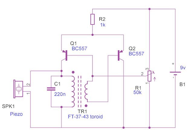

    0 shabaz over 6 years ago
    Hi Steven,
    There's quite a few ways, but I don't know of any single off-the-shelf sounder that is pleasing. Mostly they are designed to be unpleasant and to alarm : )
    I did a doorbell project a while back, and I concluded that if I wanted a nice chime, then I'd need to do it digitally, so that's what I did, it involves a lot of effort though.
    If you search aliexpress, you'll find tiny (stamp sized) boards that are intended as chime effects for doorbells. They require a miniature speaker (not piezo disc).
    It's a low-cost electronically generated chime so it sounds electronic : ) You can even get sound recording boards for custom sounds, but they won't be hi-fi.
    Below is a circuit for a nice-sounding piezo output generator, it makes just a constant tone, not a ding, but it's a kind of old-fashioned design (i.e. the type that sometimes sounds as if it is drifting slightly as the battery dies : ). I found it pleasing because I like that sort of analog drift, but it is subjective.
    It requires a small tranformer to be wound though - use very thin enamelled wire (0.15mm approx maybe), the left side has about 100 turns, and the right side has 18 turns (you can wind the right side one on top of the other one. You can replace R1 with two 22k resistors if you like (it's not critical) and the circuit runs from 1.5V to 9V.
