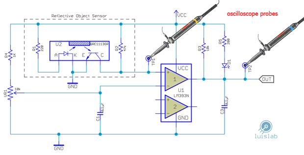

I've been prototyping with a Reflectance Sensor to be used in different applications with a micro-controller, mostly as a speed sensor and as an encoder. My goal is to try to use it as best as I can at high speeds which at the end of the day is just reading Reflectance -or Not- for pulses that last a very short amount of time. Below is the Schematic in question - this design is not originally mine but seems to be the go-to design for many hobbyist IR Sensors.
First I tried working with just the circuit enclosed inside the Reflective Object Sensor area which produces an analog signal, but at high speeds the signal doesn't rise fast enough, with that in mind, leaving out the Comparator (LM393) or any solution that helps mitigate this problem is probably out of the question.

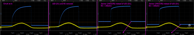

  1. Low Speed test: to my surprise, I noticed that the LED helps in the design image. It helps the signal rise faster or makes it look more like a square wave -which is a good thing as I'm reading the output using an external interrupt. I noticed when the LED (D1) is replaced with any diode, the output looks even better (on the downside it adds a ringing to the base voltage). Could someone explain why a Diode seems to help here? and why, as I increase the value of R5, the Base voltage tends to be lower? -again another good thing for the design seems. In this test I tried different diodes 1N5227B Zenner Diode1N5227B Zenner Diode, 1N914 Signal Diode1N914 Signal Diode and 1N4007 all with the same results.

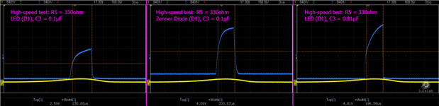

  2. High Speed test: It seems that the current value of C3 is too high and affects the output when the sensor is reading reflectance at high-speeds (the pulses don't rise high or fast enough for the micro-controller to read High). In that case, what could be a better trade off? - adding the Diode and/or lowering C3 to lets say 0.01µF.
  3. Keeping the LED: adding the Diode seems to be a good approach -or maybe there is a different way-. What could be the best way of keeping the LED also? -It's a great way to have a visual feedback when the sensor is doing it's job and also to help calibrating the sensor.
If you made it this far, thank you for reading. Please let me know what you think in the comments.

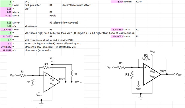

    Thank you for all the tips. I just tested the hysteresis with this simple calculator, it is working very well... no LED, C3 or diodes added!. I do have my excel too image, this formula will go in there for sure!

    Ah, I see, good idea trying it on a breadboard first to iron out the design. The hysteresis calculation is a little complicated, it is described here in section 2:
    http://rohmfs.rohm.com/en/products/databook/applinote/ic/amp_linear/comparator/gpl_cmp_hysteresis-e.pdf but it's worth trying the recommended values unless you need to tweak it. If I need to do that then personally I just rely on a spreadsheet (I have entered it into an Excel file and I can type the threshold values in it) and it outputs the resistor values) - I wouldn't be able to derive it without following a book. It is a messy spreadsheet just for personal use, but really just contains the formula from the datasheet.
    I do this quite a lot, whenever I see something that I might want to re-calculate, then I just store it in my Excel file as another sheet, and paste in any diagrams too. Like an engineering version of OneNote..  today maybe a better way would be to use a Jupyter Notebook (but it needs a server to run on your machine or elsewhere).

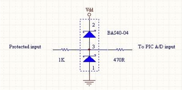

    If you want to, you could add some additional protection at the microcontroller input end. Maybe a series resistor (1k ohm) at the microcontroller input, and if you want, a couple of diodes (e.g. IN4148 for through-hole projects, otherwise for surface-mount, a single BAT54S [S suffix is important] has two diodes in it) as shown below.
    image: microchip.comimage

    I removed the components you suggested and added the hysteresis, the signal changes real fast... nice catch from your side, Thank you!  -Still trying to understand the formulas as seems hysteresis in my case only works when the resistor in series with the input is added (red arrow in the diagram)

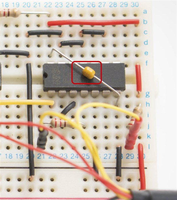

    Firstly (very important) there needs to be a 100nF capacitor* directly across the supply rails of U1. You may already have done this (it's not on the circuit diagram).
    I sometimes wire it diagonally across the chip, to keep the leads short (example photo below of a different chip, but you can see how it is placed on top of the chip to keep the length as short as possible).

    * 100nF axial capacitors100nF axial capacitors are convenient for wiring across the chip, but really any 100nF capacitor will do.

    0 dougw over 6 years ago
    The rise time is governed by the time constant formed by C3 and the combination of R2 and R5.
    Because R5 is smaller than R2, when it is in the circuit (when the diode is in the circuit) the rise time will be shorter.
    If you short out the LED the rise time will be even shorter.
    If the resistance is small - where the current through it is the max the output can sink, the rise time will be shortest.
    Open drain comparators will always suffer if there is capacitance on the output.
    If you remove the capacitor (C3) and the ringing is too severe, try clamping it with low capacitance diodes or zeners.
    Or you can use a push-pull comparator which will have faster rise times.
    • Reject Answer
