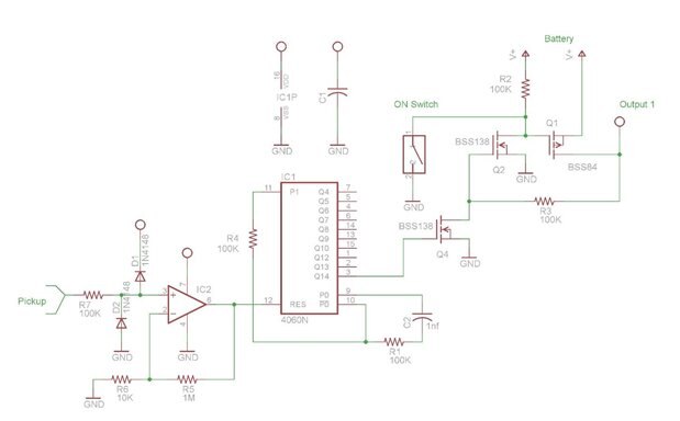

    0 dougw over 6 years ago in reply to cookekeyes
    R1 and C2 control the oscillator. The period is about 0.22 x R x C and the counter is counting 16384 cycles to give the delay.
    R1 could be 1M and C2 could be up to about 0.22 uf. Which would provide up to about an hour if my calculation is right.
    You could use different outputs from the counter if you want to cut the time by powers of 2 without changing any components. So one connection could be set to 5 min, another one could be set to 10 min, and a third could be 20 min. Or you could use a potentiometer for R1 and make the time adjustable.
    Incidentally, the output will turn off half way through the period of the counter pin, so the example above might be half an hour instead of 1 hour.

    Thanks a lot for the schematic! I think 5 minutes would be the absolute minimum I’d be comfortable with. Ideally, it would be around 10 minutes after no signal. So to change this time, I would need to change the resistors correct? But which ones?
    Also, is there a way to do this without the momentary switch? I’d prefer it to work by itself without me having to press anything to activate the circuit. If at all possible, I’d like it to function solely from the guitar signal (or lack thereof)
    I can read the schematic, but like I said, I’m a complete novice when it comes to electrical engineering.

    0 dougw over 6 years ago in reply to genebren
    Thanks genebren … I'm glad someone is "doin the math" - I didn't spend much time on calculations - until someone wants to build it....the circuit is easy to adjust to a larger delay period with larger RC values.
    • Reject Answer
    0 genebren over 6 years ago in reply to dougw
    Doug,
    I don't know if I am confused about the timing, but I come up with something like turn off in 3 seconds after last signal.  I am getting a frequency of oscillation of ~ 5583Hz and a count of 16384, yielding a delay of ~3 sec.
    Gene
    If you aren't into buying a computer and programming it, you could try a circuit like this:
    After the circuit is turned on with the momentary ON switch it will stay on for about 5 minutes after the pickup has gone quiet.

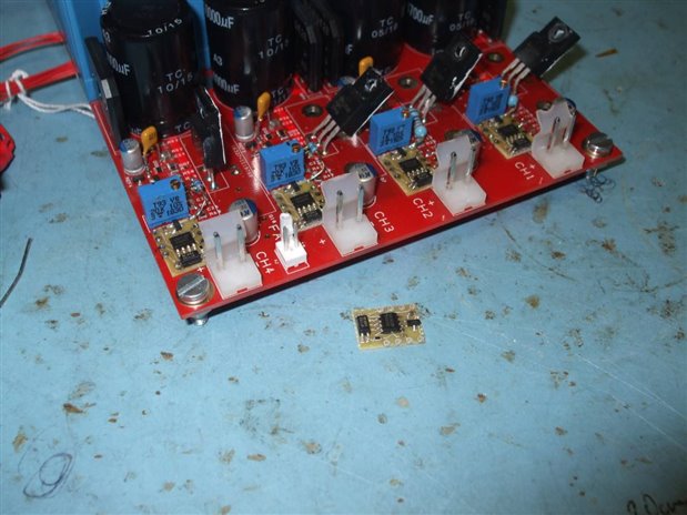

    Almost certainly best to base it on a tiny processor. There will have be some connection to the guitar to check the signal. I recently used some of these for an emergency patch -
    STM32G031J6M6, ARM processor with ADC in 8 pin SOIC package - can run at 2MHz clock and use about 0.2mA - which I guess will be a lot less than the normal operating current.
    Once the power has gone off the processor can sleep and draw less than 1uA (battery run down in 500,000 hours) - other bits may use more power !
    You could use a TI TPS22810 for the power switch. You'll also need a micropower regulator for the processor.
    I've attached a picture of my STM32G031J6M6 application to give you an idea of achievable size:
    I'm not offering to design this for you - I have time to help a bit but not to do it all, it would be an ambitious project for a novice - you might be able to team up with some other people.
