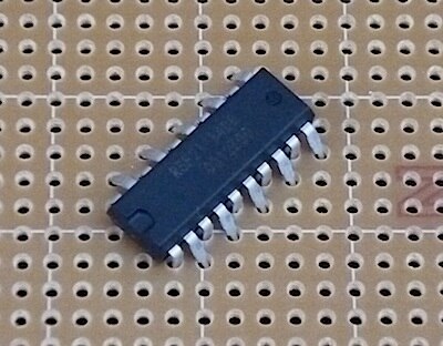

    0 e14 Contributor over 11 years ago in reply to clem57
    Hi Clem,
    Believe it or not but I found the answer and, believe it or not, it's actually simpeler than I thought. See the image....
    Yeah found that those two, aside from the price (and the lack of a couple of pins image) it's the perfect package.
    Last night I had an idea still, what I will try is to use a set of female to male prototype wires, the basic idea is to move the pins on the z80180 so that I can get all female ends on the CPU legs. When I verified that I have 64 good connections I'll use some hot glue to keep them in place. After that I'll use a spacer on a prototype board and attach some header on to which I will solder the connecting wires. It won't be the prettiest thing but it should work just fine with color coding and labels on the headers for clarity ;-)
