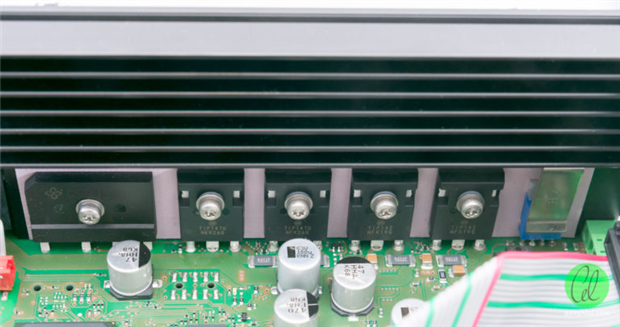

Specifically, this heatsink: Fischer Elektronik LA6/150 12VFischer Elektronik LA6/150 12V.  I'm trying to work out how that might be used so I'm putting it out there to see if anyone has used something like it or have ideas.  From what I can tell, it 'seems' to be used with a removable bottom plate for 'flat' semiconductors but I'm thinking that something like, say, a TO220 package could be attached to the side with a self-tapper.  A bit like they show with their LAM series heatsinks (PDF, sorry for the non-Farnell link!): here they show them with transistors 'clipped' to the side on the K version so I'd assume that on the non-K version, one would just screw it on.  What think you lot?

    shabaz over 4 years ago in reply to michaelkellett
    Hi Michael,
    The (little) info here also agrees with that: https://www.fischerelektronik.com/en/latest-news/press-releases/2020-fischer-pressemitteilungen/thermally-optimized-holl…     I think from memory my DC load internally has something similar, although they have attached the semiconductors to the sides, which is likely not good but maybe it was practical for the layout. Quite good that there is the panel to make the heatsink independent of the enclosure, so that the circuit can be tested even with the project enclosure lid off, since that would normally cause issues with the fan ducting.
    Edit: on the other hand, I wonder if they also sell the same product without the fan attachment, in which case the panel might not be supplied, so that it just radiates vertically out through holes at the top of the chassis.

    michaelkellett over 4 years ago in reply to Andrew J
    From the data sheet it seems clear that Fischer expect the devices being cooled to be attached to the bottom (thick) face.
    It's the only face with flatness and roughness specified and the text says:
    "semiconductor mounting surface for milled flat"
    I would expect the thermal impedance for devices attached to the side to be a lot worse, and to the sliding plate pretty awful and unpredictable.
    It isn't a very good shape for TO220 devices.
    How much power are you trying to shift from how many devices ?
