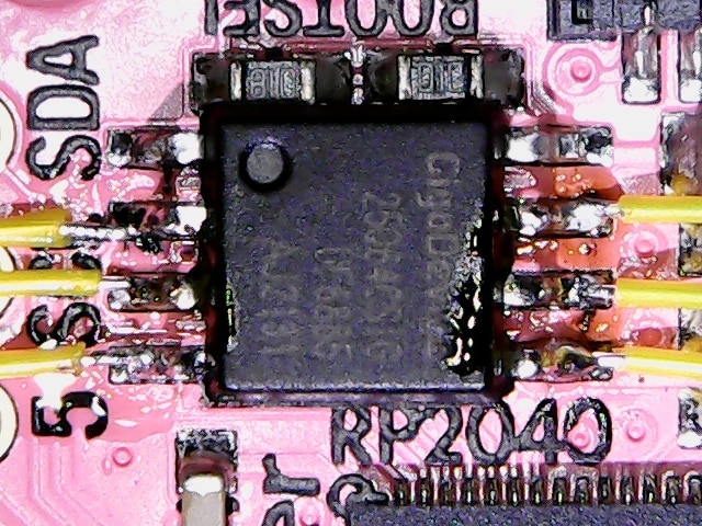

When the microscope was adjusted for a magnification of 50x the resulting field of view had a width of 12 mm across :
That is a little bit smaller than I’d like but it is what it is. I would have like to capture maybe say 50 mm across, but I would also like more image resolution…
Here are some random photos I took:
At maximum magnification, the lens casts a shadow onto your viewing area. So, you need to provided external lighting in that case.

    It looks really useful.  What really amazes me though with the photos is how clean your PCBs are!!  What's that all about??
