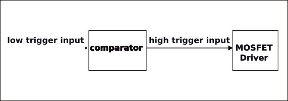

With Vcc at 5V and Gnd at 0v, why does my LM393N Op Amp output 0.7v when I/P 1(-) is connected to Gnd and I/P 1(+) is 2.5V by connecting to the middle of 2 x 5kOhm in series across Vcc and Gnd???
I was hoping to get 5V O/P to drive a MOSFET Board for a 12v power control over a magnetic field coil…

    Cheers. From the results, it sounds like there is a pull-down resistor on that signal on the MOSFET board.

    That worked until I attached it to the MOSFET Board.  Settled on 660Ohm.

    I tried a 2k and it draws the signal to Hi, but once I connect it to the MOSFET board the signal goes low.  I worked the R Value down to 660Ohm using three x 2k and that works now.  Thanks..

    That is correct..  I have applied a 660Ohm pull up resistor as suggested above and it now works.  Clearly the MOSFET board was pulling the O/P voltage down.  660 seems a good compromise

    The mosfet module you are using is similar to the one I have selected other than mine has two mosfets for driving.
    I blocked diagram what I think you are trying to accomplish. Can you confirm if this is correct?
    You have in an external input that is low when triggered. You want to use that low to trigger a mosfet driver that requires a high to trigger. Your plan is to accomplish the signal inversion using a comparator.
