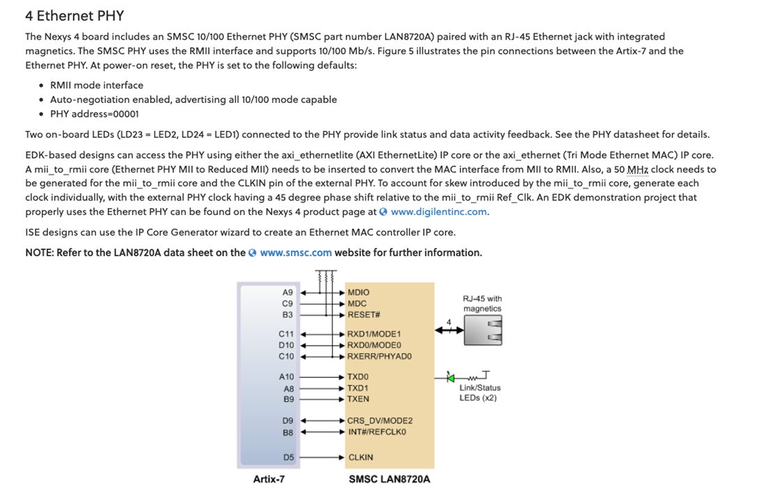

    4. For RMII specifically: learn the interface first
    RMII is not just “some pins.” It is a synchronous interface around a 50 MHz reference clock.
    Typical RMII signals:
    Signal Direction Meaning
    REF_CLK clock 50 MHz reference clock
    TX_EN MAC → PHY transmit data valid
    TXD[1:0] MAC → PHY 2-bit transmit data
    CRS_DV PHY → MAC carrier sense / receive data valid
    RXD[1:0] PHY → MAC 2-bit receive data
    RX_ER PHY → MAC receive error, sometimes optional
    MDC/MDIO management PHY register access
    Microchip’s KSZ8081 datasheet states that REF_CLK is a continuous 50 MHz clock used as the timing reference for TXEN, TXD[1:0], CRS_DV, RXD[1:0], and RX_ER. (Microchip)
    So the first question is not “is my VHDL correct?” The first questions are:
    Is the PHY strapped into RMII mode?
    Is the 50 MHz REF_CLK present?
    Who generates REF_CLK: FPGA, PHY, or oscillator?
    Can I read the PHY ID over MDIO?
    Does the PHY report link up?
    Is reset released correctly?
    Are the I/O voltages correct?
    TI’s DP83848 RMII application note also says RMII mode requires a 50 MHz external CMOS oscillator source and correct strap configuration at reset. (Texas Instruments)

    I want to try to implement ethernet.
