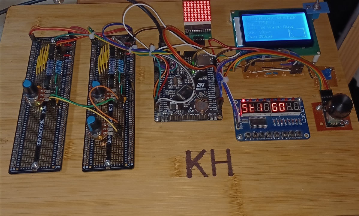

Boredom hit again, so last weekend i knocked up this, a basic duophonic synth 64 step sequencer
Built on the fly no diagrams, just used data sheets for IC pin locations.
                                       It really is mad what one can do when boredom hits.
Duophonic playing two note's/Voices at same time.
one up from Monophonic = playing single note/voice
and not Polyphonic = playing three or more note's/Voices at same time
STM32F407, programmed within the Arduino IDE,

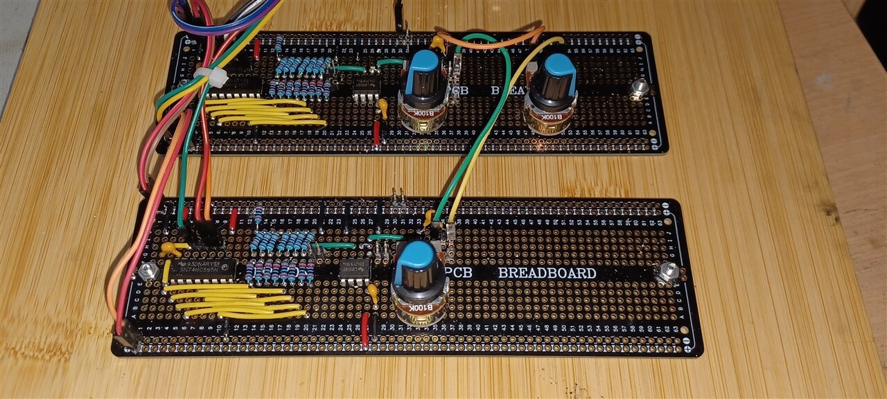

with 2 Sinple R-2R ladder DAC's, using 8bit shift register,
8x8 led matrix module,
tm1638 7seq display with 8 buttons
128x64 lcd.
Rotary encoder switch
My two basic 8bit DAC sound card's
My taty build
and here is a silly demo, of the old skool 8bit sounds, running through a 64 step sequence

    Now expanded to 256 step, simple basic editor so can now load and save pattern and added 8 x 32 dot matrix led, and an updated short.
    Will try AFSK tape store and load next, now i have tx and rx working.

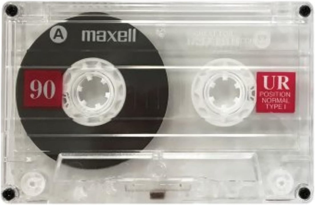

  • Knighthawk_140
    Knighthawk_140 4 months ago in reply to michaelkellett
    6 meters of punch tape, lol no
    a standard C90 Cassette will do just fine thanks,
    for anyone reading this tit for tat chat, that are not old enough to know,
    this is what us older people had to use back in the 1980's for saving computer programs, data, and games like playing Atic Atac on the specky
