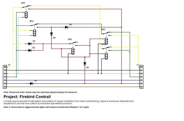

  • sdwilson
    sdwilson over 7 years ago
    Here's how to do it with relays
    DIODE D6 MAY BE REDUNDANT OR RY1 MAY REQUIRE A DIODE LIKE D6 HAS TO PREVENT A MINUTE FLICKER DUE TO RELAY LAGGING
    This will retain the indicated direction when brake lights are on while lighting the brake lamps
    I also have a logic block and ladder equivalent.
    Basically while both left and right are on then (If left indicator is on then turn on left indicator but if right is also on then cut left indicator to create the flash)
    Yellow is left indicator
    Green is right indicator
    White is ground or 0v battery neg
    Red is brake light - This has pass through if connected to a non USA vehicle
    Blue, Brown, and Black are just pass through wires for service aux, tail and reverse.
