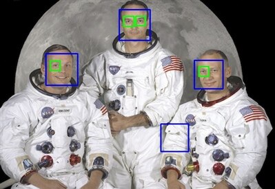

The code reads a test file and then passes that to the detect function. The detect function creates two classifiers, one for faces and one for eyes based on the example XML provided with OpenCV. It grayscales the image for faster processing and then detects faces, for each face found it draws a rectangle and the checks for eyes. If it detects eyes on the face then it's a hit and we have found a person.
I tested my classifier with some astronauts and it detected three of them although interestingly spotted a face on one of the crumpled sleeves. On my laptop it takes about 1s to load and process the (615x425) pixel file.

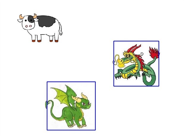

Training a classifier
I followed this tutorial to create my classifier xml data, althought I had to drop the featureType parameter as that caused it to crash on my system. The training application is very hungry for memory and used about 2.5GB on my system for image sizes of 50 x 50. It ran one of my CPUs at between 50% and 100%. When I repeated the test with a 100 x 100 image the memory usage shot upto 8GB, although it should be possible to control this with the buffer size settings. However, I reverted to the 50 x 50 and increased the number of cycles of training as that is apparently what gives the quality results rather than the size. The training programme does seem to crash rather than report sensible errors, it also crashed for me when I put in really large image sizes. After 30 minutes I had my first prototype classifier.

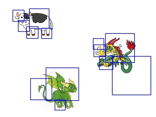

Testing
My initial testing provided too many false positives so I found a 1000 more negative images and added them to the training, I also set the maxFalseAlarmRate to a smaller value and set my training going again.
This time the training took a lot longer, nearly 15hrs later the classifier was trained and it worked a whole lot better than my first version.
