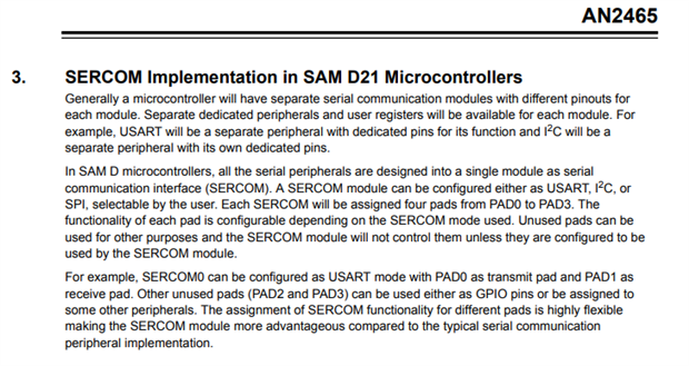

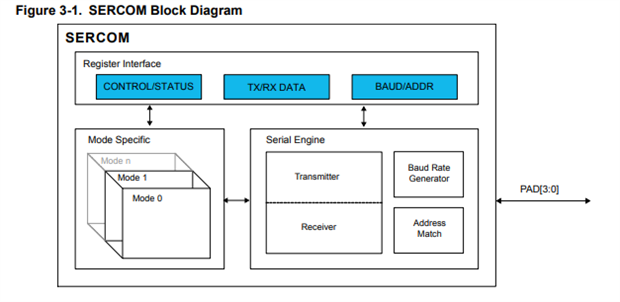

Sercom
Digging further, I found that the SAMD range of microcontrollers use a serial communication module or Sercom which can implement several types of communication.
From Microchip App Note 2465A
The SAM D21 chip has 6 of these SERCOM modules available. However, these do have some default configurations such as use by the onboard SDCard reader.

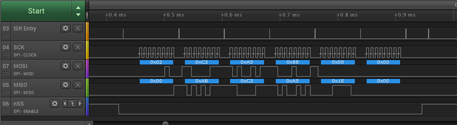

Unfortunately that's as far as I got. Not knowing if my device was faulty or if my SPI Slave was faulty.
I found a UART image that could be used on the device instead so I've swapped to that instead.

    I realised after the fact that I can test the SPI slave by using a second arduino as the master. So I may just do that.
