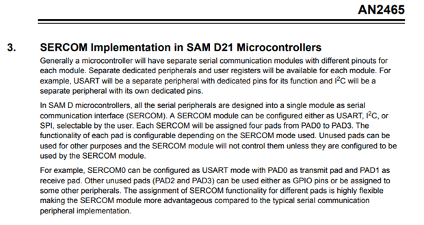

Digging further, I found that the SAMD range of microcontrollers use a serial communication module or Sercom which can implement several types of communication.
From Microchip App Note 2465A
The SAM D21 chip has 6 of these SERCOM modules available. However, these do have some default configurations such as use by the onboard SDCard reader.
