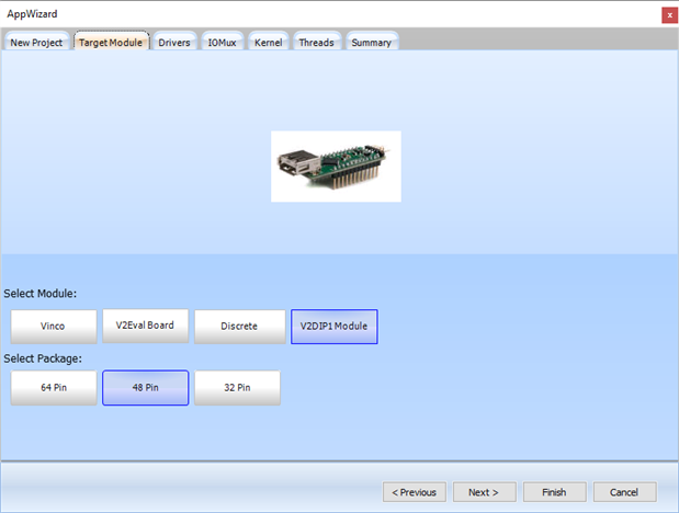

The first step on getting to blink is to install the tools. https://www.ftdichip.com/Firmware/VNC2tools.htm

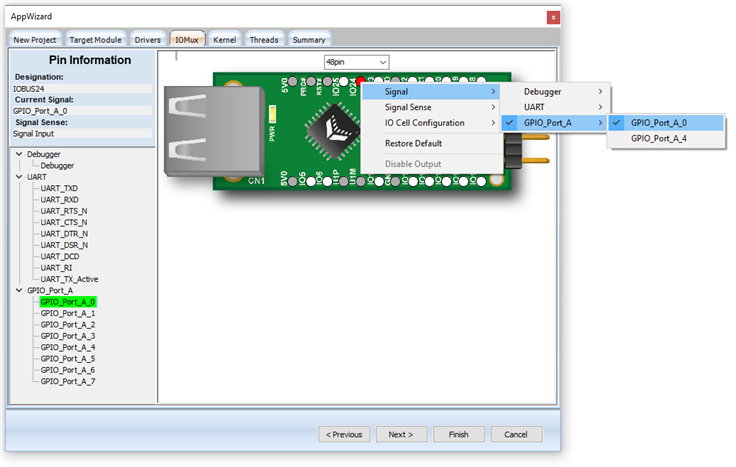

There's a simple IDE called "Vinculumn II IDE"  and you can compile the code from there. There are also some wizards and one that on first impressions looks like it should help the issue with multiplexing, you pick the target board then select a pin to configure it. You can see which pins and signals you can choose from.
It generates some code for the multiplexer configuration based on the pins you pick in the diagram, so I picked IO5 and IO6 as I knew they were hooked up to the two green LEDs.
I ran the code up in the debugger and confirmed that my device was indeed being recognised as a 48 pin variant. Note that you can create the code for the other two versions too.
But this didn't seem to work.

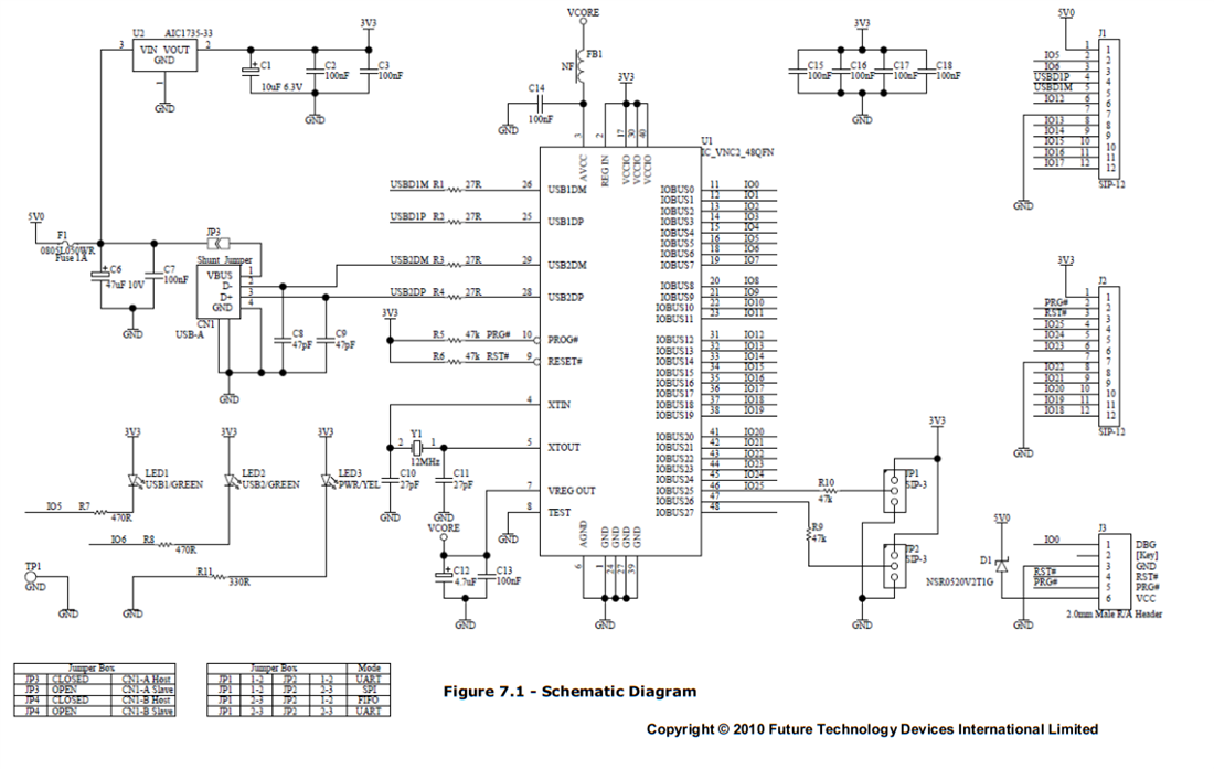

If we look at the schematic for the schematic for the V2DIP1-48V2DIP1-48 IO5 is actually on pin 16 and IO6 is pin 18, not 22 and 24.
So I adjusted the mapping as follows:
// GPIO_Port_A_1 to pin 16 IO5 as Output
vos_iomux_define_output(16, IOMUX_OUT_GPIO_PORT_A_1);
// GPIO_Port_A_2 to pin 18 IO6 as Output
vos_iomux_define_output(18, IOMUX_OUT_GPIO_PORT_A_2);
