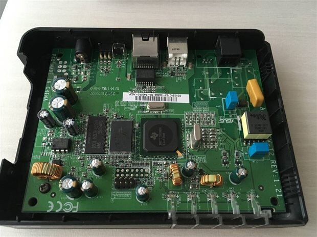

After about 12 years, our ADSL modem ASUS TI4631 stopped working. The ADSL connection didn't work and it was only possible to open the web management console, log in and see the home screen (with no useful information). All attempts to see the configuration, reset it (both software and hardware) didn't make the web interface to work.
So I opened the box and saw a few electrolytic capacitors inflated.
All capacitors were made by Teapo and were of SC series (low impedance, high ripple) and SY series (low impedance, long life series).The most inflated were the SC ones, used near a switching power supply, I guess.

After assembling everything back together and powering the modem, I found out that the behavior is similar. It seems that something has improved, the web configuration can be accessed, but stops responding after a while.
So this repair is "mission: failed".
Do you have any tips for repairing commercial products and replacing components? Do you use any special equipment? Or are just my hands clumsy?

    It has a console port available, and you may be able to connect a serial terminal session to it. It may have lost it's configuration, so have a hunt around about reflashing the firmware. You have nothing…

    Good idea, Mark, probably the last thing to try (with my level of experience). I usually download and archive the latest available firmware for all devices, especially to those, that are not updated anymore.
