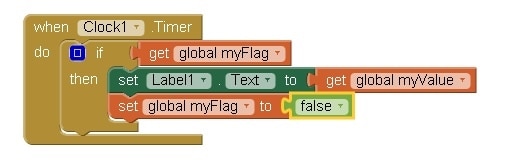

This should be followed by a second code Block which will be executed each time a Timer or Clock ticks:
when Clock1.Timer
  do
    if (myFlag)
      set Label1.Text = myValue;
      set myFlag = FALSE;
We will also need to declare 2 Global Variables to pass the Flag and the value of thumbPosition between the code Blocks.:
Below are the variable declarations and the changes to the Slider code Block  to use the variables. Note I have used the round fuction to convert the floating point value of thumbPosition to integer:
Now to incorporate the Clock - which by default, will have a cycle time of 1000 mS.
Switching to the Design screen, we drag a Clock across to the display and drop it. The Clock is a non-visible component and positions itself below the display.
Returning to the Blocks screen, we can now create the code Block related to the Clock:

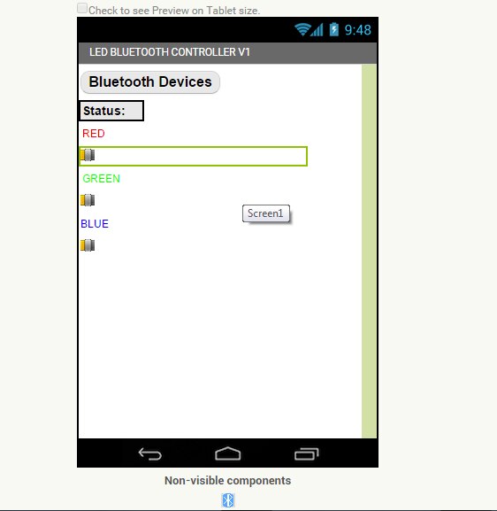

We need a ListPicker, a Label to display the connection status and a Button to disconnect from Bluetooth
The new screen layout becomes:

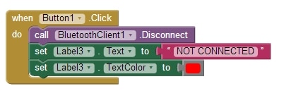

And, of course, the disconnect Block:
