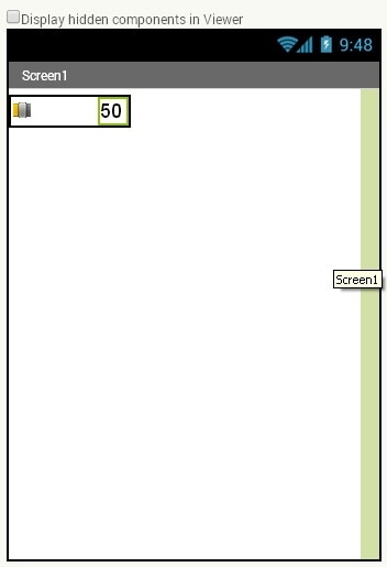

Development of the basic Slider App
Above is a screenshot of a simple  Android device display, containing a Slider and a Label to hold the current value of the slider, in a Horizontal arrangement to put them side by side.
The default Slider settings are Minimum 10.0, Maximum 50.0 with an initial slider setting of 30.0.
For use in controlling an LED, try setting Minimum 0, Maximum 255 and initial setting 100.
We should also make the Slider wider - I set it to 250 Pixels wide:
It’s very helpful if you connect your Android device to App Inventor at this stage so that you can see how the App behaves and how it needs to be developed.

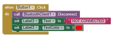

The connection Blocks are here:
And, of course, the disconnect Block:
