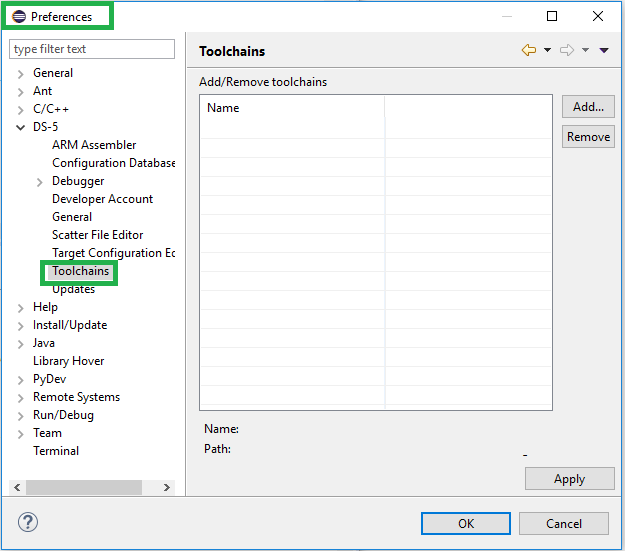

Configure the Toolchain in DS-5
Start DS-5, and navigate to Window - Preferences menu.
Search DS-5 - Toolchains
Press the Add button, and navigate to the folder where you've just installed your chain.
(for me: D:\users\jancu\Documents\elektronica\arm\linaro\gcc-linaro-5.3-2016.02-i686-mingw32_arm-linux-gnueabihf)
Apply your changes, and restart DS-5 when asked.
