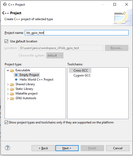

Start Code Composer Studio and start a New -> Project
Select an Empty project, with Cross GCC as toolchain.

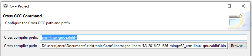

Press Next until you are asked for the toolchain details.
The prefix: arm-linux-gnueabihf-
Path: the bin folder of the location where you extracted the toolchain (in my case: D:\users\jancu\Documents\elektronica\arm\linaro\gcc-linaro-5.3-2016.02-i686-mingw32_arm-linux-gnueabihf\bin)
Finish.

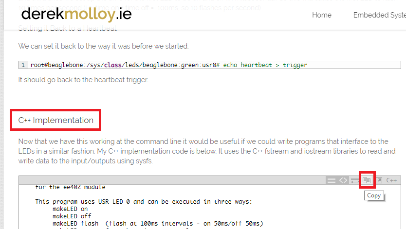

For the content, I used Derek Molloy's C++ makeLED example: Beaglebone: Controlling the on-board LEDs using C++ | derekmolloy.ie | derekmolloy.ie
Copy the source and paste it in the cpp file you just created.

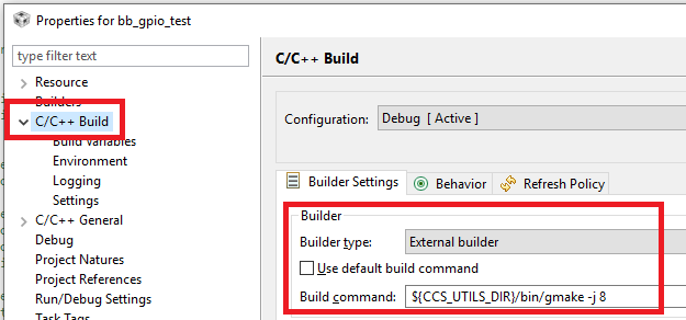

If CCS complains it can't find make, go to Properties -> C/C++ Build -> Builder settings.
First try the Internal builder and build again.
If that step fails, manually select the builder.
Uncheck the Use Default build command.

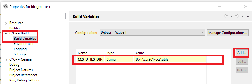

Enter the path of the CCS make utility: ${CCS_UTILS_DIR}/bin/gmake -k -j 8
Set the CCS_UTILS_DIR to the ccs\utils subdirectory of Eclipse.
Build. You should now get a Binaries folder in your project, with the Linux native executable.

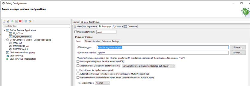

Deploy and Debug
Go to Run -> Debug configurations, and add a new C/C++ Remote Configuration.
When you select the project, it will automatically find your executable too.
Press the New... button next to Connection, and make a connection to your BB. The host name of your BB should be beaglebone.local.
You can use user name and password (debian/xxx) - or if you have enabled secure key logon with your BB, you can use your private certificate.
When the connection is entered, you can Browse... for the location on the BB where you want CCS to deploy the binary.
I created a bin folder in my BB home, so I select /home/debian/bin.

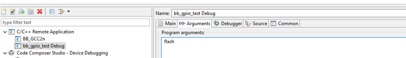

In the Arguments tab, you can the arguments that the debugger will pass to your application at start.
Derek's app expects one parameter that tells it what to do with the LED. I passed flash as argument. It will flash the led in a half second on - half second off pace.
Then define the debugger (GDB client) installed on your computer. The one of the Linaro toolchain isn't called gdb but arm-linux-gnueabihf-gdb.
You should not have to install the debug server on the BB if you use a recent Debian image. It's there already.

Push Apply.
Go!
Push the Debug button. CCS will upload your executable to the BB, load the main file in the debugger and stop at the first instruction.
