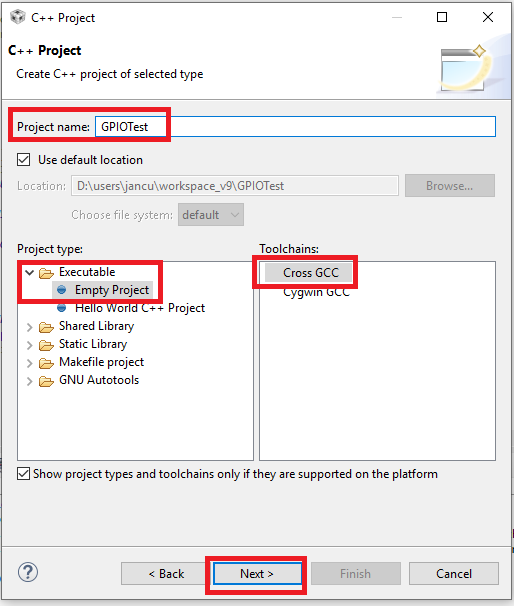

File -> New - > Project -> C++ Project
Name it GPIOTest. Select Empty Project, Cross GCC (we use the Linaro GCC cross-platform compiler).

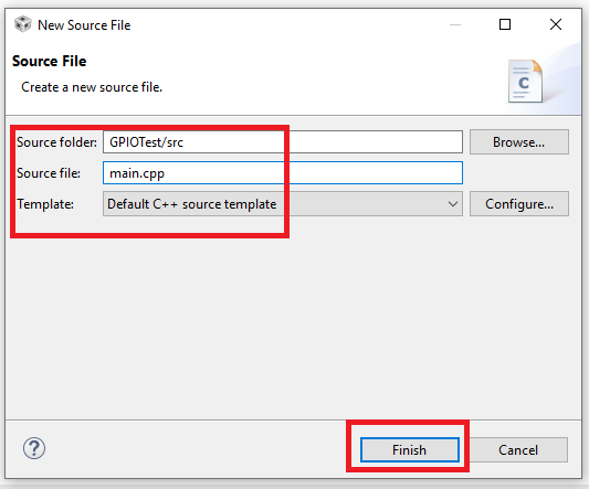

Make a new folder, called src
In that folder, create a new C++ file called main.cpp
Copy the following source (I got it from martinvalencia - It's the source he uses to test the library, I don't know where it is coming from)

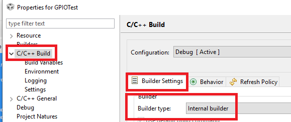

Set the builder to Internal:

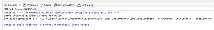

That's it. Build it.

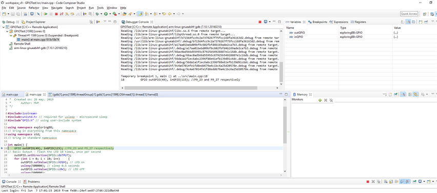

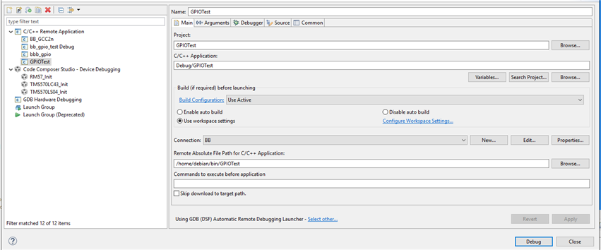

Now it's time to debug. Copy one of your working debug configurations and adapt it for this project.
If you don't get something like this, you may want to re-read this blog: BeagleBone: Build and Debug a Linux C++ Program with Code Composer Studio
