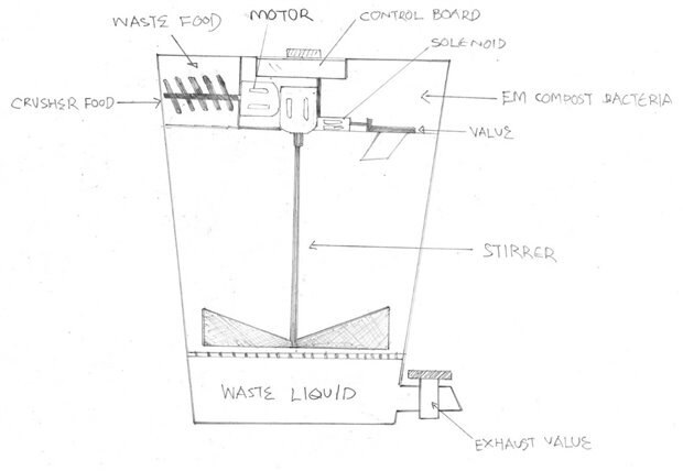

Concept of the project
f we can reduce the food waste from every house. It will reduce the cost of garbage management for the city.  And if we can recycle food waste. it’s will improve the environment.
This project “ Food waste recycle bin “  will convert waste food into natural organic which we can use to plant the tree.
Users just put waste food into the slot for the crusher.  Food will be shred into small pieces and the controller will open the valve to fill up the tank with EM compost.
This substance will help dehydrate the waste.  The controller will start motor to stir the waste to mix all together.  This bin will be installed outside house
for solar heating. We are planning to use DC motor 12 V which make it possible to use solar cell in the future which is suitable for remote area or camping site.
Next step
We are looking into any available components that can use in this project. To make all from start is expensive and time-consuming.  But if we can select some
part that available in the market will help us reduce cost and time. For example, waste food crusher we may use meat grinder to crush waste by simple add motor
to power it.

    I think the concept is good as it would be nice to have some sort of machine/box thingy that you could just put organic waste into and get useable compost out of it. This is the basic process of a compost heap and I do much the same with that. Cut up the organic waste into smaller pieces, pile it up, occasionally add some garrotta and then very occasionally remove the rotted material and put onto my vegetable beds, although I have never had any liquid come out of the bottom.  There are problems with an automated process as cutting or grinding the waste can be difficult as everything can get jammed up, especially with hard sticks and 'mush'. I do have a stirring rod thingy for the pile but it is really difficult to get it to turn and mix up the rotting compost and I'm thinking of getting two compost bins so I can mix up the rotting material by just moving it from one bin to the other.
    I look forward to seeing your implementation.
