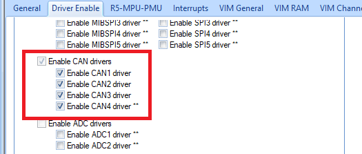

I'm using a Hercules TMS570LC43 LaunchPad. The controller has 4 DAC modules. I enable all.
Then I configure a message sender (1) and receiver (2) for each of the 4 CANs. The message ID for sender and receiver have to be the same (I use 1), otherwise traffic is ignored by the receiver.
Interrupts are enabled on the receivers.
The image shows CAN #2. The setup is the same for all 4.

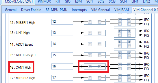

The high interrupts for the 4 CAN modules have to be enabled in the VIM table.
I'm showing CAN 1 here. It's interrupt 16.
the other ones are on position 35, 45 and 113.

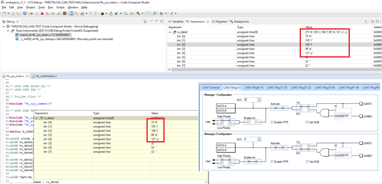

The receive buffers are empty. At the end of the program they should get the same values as the send buffers.

This is a little exercise that learns how to configure the CAN peripherals. At the end of the program, the content of the receive buffers should be identical to the transmit info.
