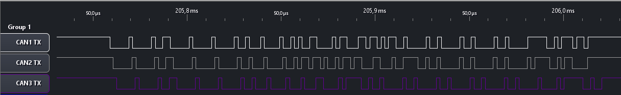

    Jan Cumps over 9 years ago
    Even though the internal loopback is enabled, you can still probe the traffix on the TX pins.
    Here's a capture for CAN 1 - 3.
    It would even be more fun if my logic analyser would understand CAN.
