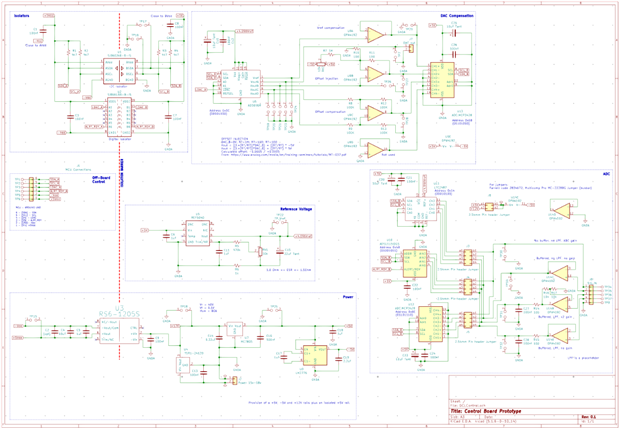

Full Schematic
Here's what I've come up with after a number of trials with breadboards; iterations whilst choosing components; and finding, and resolving, problems.  At this stage, it's just a reasonably well developed 'stake in the ground' and is likely to undergo changes following prototyping which I cover off later.
Kicad files can be downloaded from Github.
There is a larger image in the attached PDF.
The schematic is grouped by module.  I used global labels as they are a bit clearer to see than net labels but serve the same purpose.  Interactions between modules are via these global labels so I'm hoping that it's easy enough to follow.  This block diagram should help:

Prototype Design
I've described above the stake-in-the-ground design but I want to explore some of these modules and concepts a bit more.  I've realised that it's actually cheaper to get some PCBs made up than it is to buy DIL adapters for the parts so I will be doing that.  It also gives me some time to get up to speed with creating tests and using Labview - Jan's approach to testing really appeals.  I have breadboarded quite a bit of this already (not compensation) so I do know that fundamentally, or at least electrically, the design will work.
So for the prototype I'm going to concentrate on the DAC, ADC  and Compensation modules.  I also want to do this in the context of the power supply and isolation components to see how (if) they impact control and accuracy.  Specifically, I want to cover the following with the prototype:
  • Characterise different ADCs with different performance and functionality specs.  I've picked the Microchip MCP3428, Texas Instruments ADS1115 and Analog Designs LTC2487.  These are all 16-bit, Sigma-Delta converters.  I will use jumpers to route signals where I want them, e.g. individual ADCs, or all ADCs.
  • Test the OPA4192, so for each ADC: 1 channel buffered with Low Pass Filter (LPF) using the ADC to apply gain; 1 channel gained-up by x2, with LPF; 1 channel buffered with no LPF, ADC providing gain; 1 channel unbuffered with the ADC providing gain.
  • Test various compensation approaches with an Analog Devices AD5696R DAC and Microchip MCP3428 ADC.  Here, I will use one DAC channel to provide an offset amount to another DAC channel; one DAC channel compensated with the approach documented by Jan here, from the AD white paper, figure 6; and one DAC channel uncompensated that I could use to pass its output straight through to the ADC circuit (or just measure it.)
I'll describe the DAC compensation and ADC modules but the others are pretty much the same as described above.
DAC Compensation Module
Here, you can see that I will ask the AD5696R to output a signal through one or more of its channels:
  • VoutA goes to a terminal block which I can either link directly into the ADC module inputs or run a load, say a resistor, and measure the voltage drop across that through the ADC module.  Although each channel is characteristically different, this will give me a baseline behaviour to measure against as well as additional flexibility in the prototype.
  • VoutB is fed into a compensation configuration as described in the AD paper linked above.  The values I've chosen generate an offset of 5mV according to the calculation and I assume that can be adjusted with the potentiometer.
  • VoutC is used to generate an offset compensation signal that is subtracted from VoutD's signal to adjust for that error.  In theory, I can read the 'actual' output through the ADC and dynamically adjust in software to get the signal I want.  I say in theory because of course there are other errors in that signal path and the ADC will introduce errors of its own, but I think it will be an interesting exercise nonetheless.
  • Vref is used to determine the internal reference voltage used to generate the DAC output as I'll need to account for that in any software compensation.
As the DAC outputs are being read and converted by the ADC, I can also characterise that and look for software compensation of its readings.
The aim of this is to determine the likelihood of improving accuracy of DAC output and ADC measurements through software and hardware.  The three different approaches should give me some flexibility; I couldn't think what to do with the additional OPA192 input so I've tied it off.  If anyone has any ideas, let me know.

    Jan Cumps over 6 years ago +5
    I'll elaborate a little on the firmware / software. I'm still drooling over your hardware approach - so well designed. The eload has a core API. Representing all functions of a programmable load. I also…
  • jc2048
    jc2048 over 6 years ago +5
    I didn't know whether to comment on this or not. I don't have direct experience of this kind of analogue electronics, so best to regard these comments as 'thoughts' or 'musings' rather than advice. They…
  • fmilburn
    fmilburn over 6 years ago +4
    Very nicely done
  • jc2048
    I didn't know whether to comment on this or not. I don't have direct experience of this kind of analogue electronics, so best to regard these comments as 'thoughts' or 'musings' rather than advice. They might be helpful, or not. Something to think about, but feel free to disagree. And I might have things wrong or be worrying at things that don't matter.
    Minor mistake: C26 looks like it's the wrong way round.
    The switching converters are noisy. RS6 datasheet says 50mV max and TSR1 says 75mV max [both measured 20MHz B/W]. Neither would be a problem with digital logic. Not so sure with an analogue board. The RS6 will also push noise back out of its input, so your 12V rail potentially will be very noisy. How much of that will your 7805 stop? The higher frequency end will skip through via D4's reverse capacitance [and contaminate the ground], so the regulator doesn't stand a chance with that. Even with the noise lower down, it won't do too good a job and you're then betting everything on a couple of decoupling capacitors. Of course you might then say that the OPA4192 has a PSSR of 0.3uV/V (better than one part in a million), but look at the graph of PSRR against frequency. The figure they give you is for 1Hz, or something like that, because that's where the chip is at its best. By the time you're up to 1MHz, the PSRR has reduced to about 20dB (ie one part in ten) which means a lot of noise just running through the op amp and appearing at the output. So you'll be back to relying on the decoupling. Speaking of which, it's always a good idea to have a decoupling capacitor right at the device pins.
    Powering chips from a reference feels wrong to me. The DACs include digital stuff that will inject noise onto the reference.
    You might have problems with the reference stability if you have multiple tants hanging on the output. It will complicate getting the ESR right.
    Although the OPA4192 has a good input-referenced noise figure [5.5nV/root Hz], it also has a fairly high GBW figure (about 10MHz). That means, for a unity gain buffer, 17.4uV at the output. I think that's an RMS value, so the excursion is more [unlike a sinewave, for noise I seem to remember a figure of 6x is a reasonable approximation for the pk/pk value - might be wrong there]. In practice, the noise will be a little higher, because the 5.5nV is just the white noise [thermal and 'shot' noise] and doesn't include the low frequency 1/f ['flicker'] noise. You can deal with it either by restricting the bandwidth [if you don't need it] by choosing a slower op amp or by modifying the feedback network, or by simply filtering what comes out, or by doing multiple conversions and averaging.
    • Vote Up +5 Vote Down
  • Andrew J
    Andrew J over 6 years ago in reply to jc2048
    Thanks Jon/Jan - feel free to comment away, I'm always interested in insights which I follow up on.  Good spot on the capacitor, it must have got inverted as I was moving stuff around.
    I hadn't considered the extra capacitance on the REF5040 and you're right it likes a specific ESR range on the output which is hard to achieve with tantalums - the one I chose for the ref output seems to have the right ESR at low frequency but of course I'm paralleling that up!
    Noise: that's been a real frustration for me.  I've spent days reading around the subject, doing calculations and so on and getting nowhere.  I follow (and understand) various white papers and end up with what feels like crazy figures.  For example, I followed a TI reference paper with calculations and whilst their example ended up with something like 64nH and 66uF for an LC filter, my calculations gave something like 66nH and just under 1mF!  Even calculating a low pass filter for the op amp outputs gave me a figure of around 56kOhms for the R which can't possibly work for the ADC.  The biggest problem being that datasheets just don't give all the necessary information.
    I swapped a 5V TSR for a LM7805 (SMD equivalent) because of the noise but I had expected that to work reasonably well: the spec for this part show a ripple rejection of 65dB with a Vin of 11V (I'm using 12V) at 120Hz and from the graphs, ripple rejection ranging from 80dB at 10Hz, 68dB at 100Hz and 70dB at 10kHz.  The graph for attenuation as a function of output voltage, 5V, gives a ripple rejection of 80dB.  I'd assumed that this was the frequency that noise was attenuated at (so higher frequencies would be attenuated) - is this wrong?  Perhaps I'd be better off without D4 if it's going to negate any noise attenuation benefits - it would be easier to live with the loss of a cheap part in the event of catastrophe than having to deal with noise pollution?  I'd put it in really to deal with any capacitive load that might get connected.  There are other means of mitigating disasters with, say, a DC load connected.
    For the 12V TSR, I could certainly swap that for an LM7812 equivalent and I had thought about it.  I already have the 12V TSR and I'd assumed that its output being used to drive the RS6 and a Fan, ripple wouldn't matter so much for those and I was expecting the 5V regulator to attenuate it.  The RS6 as a DC/DC isolator actually had the lowest output ripple of the variants I checked out but isn't great in any case: the digital side on the breadboard certainly worked ok and I was measuring about 30mV pk-pk ripple.  I just couldn't identify an alternate way of getting isolated power to the digital side of the board but if you have any other ideas that don't involve either additional power supplies from the wall or plugging into a PC's USB port I'd be very interested to hear them.  Again, I'd looked at putting a filter on the input side of the RS6 but ran into the same problems of not having enough information from the datasheet and calculating ridiculous values - actually, the datasheet gives an input filter for dealing with EMI but I thought that was a different thing.  I'd also tried modelling something in LTSpice but I struggled to work out the correct way of representing it.  In the PCB that I'm working on, I've separated the grounds for the RS6 and the rest of the circuit and tied them together at the Vout pin - I couldn't figure out a better approach from my limited experience (this is from my prototype, not the main schematic, so reference ids may be different):
    As for the LM2776 vs the LM2662 that Jan references (Jan, you mention LM3662 but I think you meant LM2662), there both switched capacitor inverters but I suspect that I may have an additional problem.  The LM2776 operates at a much higher frequency and ripple is dictated by both output current and input voltage and, according to the graphs, is likely to be in the low 10s of mV - I couldn't find equivalent graphs in the datasheet for the LM2662.  I suspect I don't have a big enough Cout but even so it may be that the load from the Op Amps it is driving may be too low and it will end up pulse skipping and output ripple is the poorest at low loads.  Ultimately the Op Amps are buffering the signal into the ADC inputs which will only be drawing small currents. Now, I had assumed that any load on the Op Amp output would be coming from the positive rail, not the negative rail, given that the output will always be positive - is that a bad assumption?  Not that that helps in this case anyway!  I'd also thought, I'm guessing incorrectly from what Jan says, that because the -ve supply is there to allow me to get close to 0V output then any ripple would be well outside the range that it would have minimal impact (-5V dc with around 20mV pk-pk riding on it.)
    And the OpAmp?  How does any one make a decision given the thousands of available options??  It struck me that the choice has to be a trade-off - which is what I did and described in my other post.  I'd considered that the noise was reported at the low end of frequency and not the whole story, but as part of decision making just took it that low was better and it was a parameter that was generally comparable across options as they all stated the spec in their datasheet!  I suspect that if I looked and found a slower Op Amp I'd be trading that off against something else.  My understanding of Unity Gain Bandwidth is that it is a point where gain is 1 and higher gains are achievable as the bandwidth reduces such that maximum gain will be below the cutoff frequency, defined by the Open Loop Gain.  For the OPx192, the Open Loop Gain is 110dB-126dB, say, 115dB so the cutoff frequency is about 17-18Hz.   For a DC signal (and I understand there will be an AC element riding on that) will the gain bandwidth product actually be relevant?  I thought not but...as you mentioned it, now I'm looking, particularly as you referred to 17.4uV and I can't work out how you calculated that - could you give me a clue? Yes I can and I can see what you are getting at. Ultimately, I tried to find an Op Amp with errors within 0.5LSB of the ADC but I'll look again.
    Sorry for the long post, but I wanted to respond to you and Jan where I'd gotten to thinking through to a design.  I have no mentor to steer me in the right direction except the kindness of you guys who comment.  I think I need to go back and revisit:
    • noise from the RS6 and LM2776
    • determine if the LM2776 is even the right part
    • dig more into GBW impact on DC signals and whether there is a 'better' Op Amp.
    Thanks for commenting, really appreciate it.
  • Andrew J
    Don't worry Jon, I didn't take it personally image
    I did take your comment about GBW and run with it though, as I note in a response further down this thread - basically, I didn't find anything better that wasn't trading off against another parameter!  Better choices (perhaps) were single input 0V-5V which could be powered as -2.5V to +2.5V but that requires the creation of an extra two power rails; it also then limits incoming signals to 2.5V.  I had considered this originally but decided that reducing resolution from 5V to 2.5V was not what I wanted at this stage. By that, I mean that the choice of ADC may change that decision: the MCP3428 has an input limit of 2.048V so clearly having an Op Amp with a +2.5V rail wouldn't be an issue; however the other ADCs can take an input unto Vdd (5V) so if prototyping says 'go with the ADS1115' for example, then +5V is what I want - I need to keep options open at the moment.
    Having said that, if you can identify an Op Amp that has a better balance of specifications I'm all ears, seriously.  The parametric search parameters tends to limit what can be searched for to reduce the thousands down to a manageable number so Heaven only knows what I may have missed!
    Delta-Sigma ADCs, as I understand it, will deal with a fair bit of the noise through the digital filter and oversampling process.  There's still potential for aliasing noise into the signal before it reaches the ADC input and the recommendation is to put a simple passive RC filter between the Op Amp buffer and the ADC input.  I have placeholders for such with nominal values and is something I'll look at in the prototype.  Datasheets don't always give enough information to determine what the RC values should look like and there's a tradeoff between too high an R for the ADC, too low an R for the OpAmp and too high a time constant for the ADC sampling time.
    "Two ground connections on the connectors" - do you mean in the Board I/O module?  I think I ended up with two because I had a 6-way connector on hand and didn't want to leave one connection floating whereas really that shouldn't have distracted me and this should be a 5-way connection (or 17-way altogether.)  Anyway, that's not the point of your comment so a bit by-the-by: I do think I'd have to be very careful allowing the creation of ground loops and I must have things referenced to one point.  I would envisage one of two things happening at the Board I/O: the ground connection is a star point for the down stream components; or the board I/O connector(s) are removed altogether and the 'control board' circuit incorporated into the wider solution schematic and ground adjusted accordingly.  Ultimately, everything must route back to the source of the relevant power rail, without creating the possibility of ground loops, including the components on the Control board - there lies the danger, I think, in providing multiple routes back for those components.
    Did I misunderstand your comment?  I'm happy to explore this further as, frankly, ground seems easy to get wrong and hard to get right!  I've had trouble in the past - one such example: I just couldn't get a voltage/current/power sense IC working properly because I had it connected to a different ground reference point than the Arduino 'talking' to it.  Ultimately, they both routed to the same ground but clearly there was an issue there in how I'd connected them both to that point.
  • Andrew J
    Andrew J over 6 years ago in reply to Andrew J
    I found an interesting note here (Analog Design paper on Linear Design), jc2048 (Jon):
    There are a number of important points to be considered when making signal and power connections. First of all a connector is one of the few places in the system where all signal conductors must run in parallel—it is therefore imperative to separate them with ground pins (creating a Faraday shield) to reduce coupling between them.
    Multiple ground pins are important for another reason: they keep down the ground impedance at the junction between the board and the backplane. The contact resistance of a single pin of a PCB connector is quite low (typically on the order of 10 mΩ) when the board is new—as the board gets older the contact resistance is likely to rise, and the board's performance may be compromised. It is therefore well worthwhile to allocate extra PCB connector pins so that there are many ground connections (perhaps 30% to 40% of all the pins on the PCB connector should be ground pins). For similar reasons there should be several pins for each power connection.
    This would seem to back up your comment about 'just two GND connections'.  I'll take the time to read through the paper in more detail.
  • jc2048
    jc2048 over 6 years ago in reply to Andrew J
    My concern was mixing up the zero volt reference with the power return. I hadn't gotten as far as considering crosstalk between the signals.
    Say your ground connection was 10mR [two parallel connections with 10mR at each end] and the supply current stepped by 10mA, that develops a voltage of 100uV between the two sides on the ground [which is supposed to be a fixed, identical reference for both]. That's quite significant if you're trying to digitize in 38uV steps. Of course my 10mA is plucked out of the air, because I don't know what's on the other side, but you've given me the clue there may be some digital stuff there by the SDA and SCL lines. Whatever the actual figure, it's digital noise you'd presumably prefer not to have added to the signals.
    It would seem from the document that you're quoting that an accepted way to deal with that is to minimise the resistance as far as possible through multiple connections. I though there might be a way of separating the power from the signal ground, but there isn't really, is there? If the multiple ground connections aren't more or less equal, everything then takes the easy, lowest resistance path [at low frequencies].
    The LT1028 has a voltage noise figure of 1.1nV/rootHz. But it's a bipolar part and other specs may be worse. The current noise at the input is part of the penalty you pay. There is, however, a good section in the datasheet on noise. It deals with the noise from the source resistors connected to the inputs too.
    Really I was trying to draw your attention to the fact that white noise is a function of bandwidth. If you give a noise figure [from an oscilloscope trace, or whatever], then you should state the bandwidth it was measured over. (If you look at those converter datasheets, the noise figure is over 20MHz. So it might be that they've simply used the 20MHz bandwidth limit on the oscilloscpe as the filter.) So, to reduce it, you need to restrict the bandwidth. In this case you'll use a filter, but for conditioning a slow sensor, a slower op amp might be appropriate if it does everything else you want.
    Here are a couple of app notes that have useful stuff on op amps and noise
    https://www.analog.com/media/en/technical-documentation/application-notes/AN-358.pdf
    https://www.analog.com/media/en/reference-design-documentation/design-notes/dn015f.pdf

    It should be easy enough to separate power and digital lines with ground between at the connectors.  What I do like about that document is the acknowledgement that the recommendations they give may not actually be possible to achieve when laying out an actual board!!  Useful to bear in mind...
  • Andrew J
