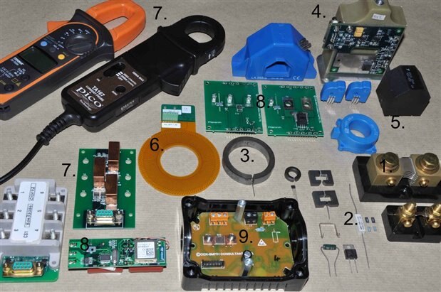

Voltage and current sensing are fundamental to electrical and electronic circuits. Pretty much all analogue parametric sensors have a voltage output that is going to be compatible with the input of some measuring device, for example an ADC or the input to an amplifier. Current sensors must in some way convert the current to voltage for measurement and in general there are 2 methods, either a resistor is in the current path and the voltage across the resistor is measured, or the magnetic field around the current path is detected and converted to voltage for measurement. In the photograph at the heading of this blog both types of current sensor are represented.

Types of current sensor:
  1. Typical current shunt resistor, 200A generates 50mV output.
  2. Current measurement resistor, 0.05R.
  3. Toroid made of silicon steel with a Hall Sensor in an air gap.
  4. Closed loop Hall Sensor, the secondary coil is wound on a ferrite core and potted.
  5. Current Transformer
  6. Rogowski coil made on a PCB with integrator and amplifier.
  7. These sensors all use a toroid, air gap and Hall sensor.
  8. These sensors use a magnetic core and Hall sensor miniaturised into a package with an amplifier.
  9. 20A current shunt in a DC electrical meter.
