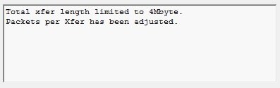

You can play with packet and queue size to check if it affects the rate, as long as the total package size stays under 4 MB.
If your settings exceed this limit, the Streamer will automatically adjust the number of packages to keep you within bounds.
The following warning is displayed:
