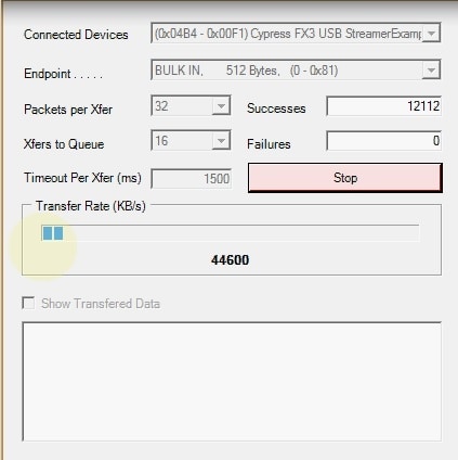

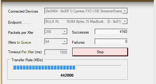

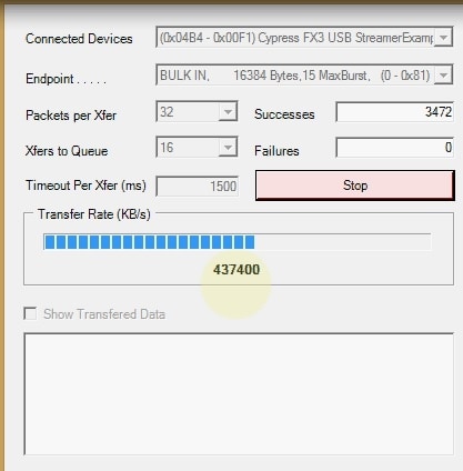

Measure Throughput of USB 3.0 and 2.0
This video is unavailable.
The kit comes with a Streamer application (+ source code!).
This app will try to stream data as fast as it can via the USB connection. It shows the transfer rate.
On my PC, with 32 packages per transfer and a queue of 16 transfers, I get 440.000 KB/s for USB 3.0, and 44.000 for USB 3.0.
USB 3.0USB 2.0

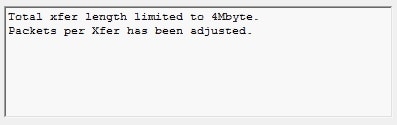

You can play with packet and queue size to check if it affects the rate, as long as the total package size stays under 4 MB.
If your settings exceed this limit, the Streamer will automatically adjust the number of packages to keep you within bounds.
The following warning is displayed:
