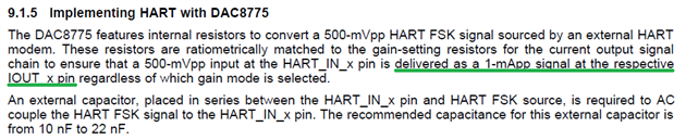

DAC8775 is also implemented with a Highway Addressable Remote Transducer (HART) Signal Interface to superimpose an external HART signal on the current output.
The HART peripheral is only useful in current mode. The HART signal is a communication component added to the current output that DAC is set to.
The DAC8775 implements the physical layer. It doesn't know HART protocol or data handling, but can generate the compliant signal on its output.
In essence, it accepts a sinusoidal signal of 0.5 Vpp, either 1200 or 2200 Hz, and translates that in an AC current component on the output of 1 mA
The image above, from the DAC8775 datasheet, shows how the DAC, when set to a  6 mA DC output current, mixes a HART signal of 0.5 mApp to it.

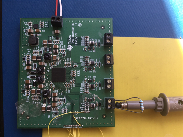

The evaluation kit used in the element14 Road Test has no breakout point for the HART inputs. On each of the 4 DAC channels, that pin is coupled to ground via a capacitor.
I'm using channel A, so I have removed the capacitor for that module's HART input - C58, and soldered a patch wire to the PCB.
The HART input signal has to be capactive coupled. The HART pins on the DAC8775 have a DC bias. I used a 0.470 µF capacitor.

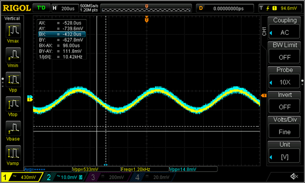

I simulate the HART signals with a generic function generator. I set it to sinus 1200 and 2200 Hz. I used my oscilloscope to set up a 500 mVpp output after the coupling capacitor of 0.470 µF.
Then I inserted the signal into the DAC and checked the output. Just like in the previous blog, I used an EEVBlog µCurrent as a load. It translates the DAC's output current into a voltage.
I attached channel 2 of my oscilloscope to the output of the µCurrent.
The yellow signal is the HART input, generated by the function generator. It's 500 mV, 1.2 kHz.
The blue signal represents the DAC's output current. Each mA is a mV on the Oscilloscope display.
You see the DC component of 10 mA, and the 0.5 mVpp AC component superposed by the HART interface.

    New measurement. I'm now paying more attention to get a close-to 500 mVpp input:
    The output is 496 mV. That translates to (edit:wrong see comments below 84.5 mA)  0.845mA with the 587R resistor.

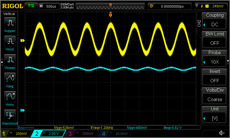

    Here's a sample using a 587R load:
    The average voltage is 5.82 V. With the 587R, it means that 9.9148211243612 mA (close to 10 mA, wich is what I requested from the DAC).
    The AC component (HART signal has 440 mVpp. That translates into 0.75 mA. Not quite the 1 mA I was expecting...
    On the other hand, you can see that Jon's advice - to use a resistor and then probe - has proven to result in a much cleaner scope trace.

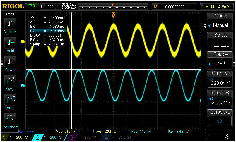

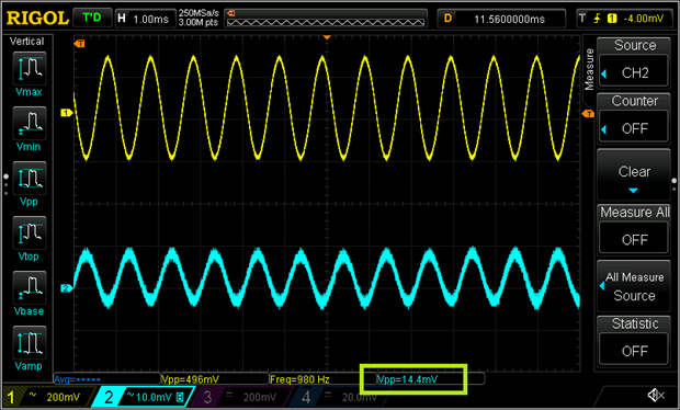

    I've used a 12R resistor and set the current to 10 mA. I alsi switched to proper probing.
    Here's a capture of input and output. The output channel is set to AC coupling, so it only shows HART component and noise.
    The scope measures 14.4 mVpp. With the 12R resistor, it means that we're measuring a current of 1.2 mA.
    It should be 1 mA according to the spec.
    I've inverted the output and then verniered the signals on top of each other to see if there are obvious delays:
