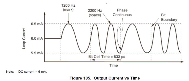

The HART peripheral is only useful in current mode. The HART signal is a communication component added to the current output that DAC is set to.
The DAC8775 implements the physical layer. It doesn't know HART protocol or data handling, but can generate the compliant signal on its output.
In essence, it accepts a sinusoidal signal of 0.5 Vpp, either 1200 or 2200 Hz, and translates that in an AC current component on the output of 1 mA
The image above, from the DAC8775 datasheet, shows how the DAC, when set to a  6 mA DC output current, mixes a HART signal of 0.5 mApp to it.

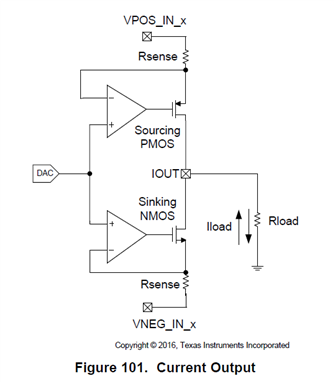

    I'm presuming here that the output is floating and the current is sourced rather than sunk, so it doesn't matter if you have the grounds on both the input side and the current output side connected to your 'scope ground (but you're now the expert on this chip, so you decide if that's correct or not).
    The input signal is capacitive coupled. My generator shares the same ground as the whole circuit.
    Here's the internal Current Output driver of a DAC8775 channel: It can source and sink.

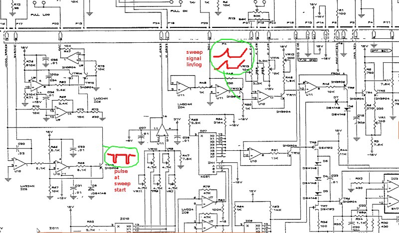

    My function generator has a built-in sweep option. It's very basic though - I can only sweep from DC to a set frequency. Not a subrange (here 1200 - 2200 Hz range would be nice).
    It does have an external input though where you can control frequency with a voltage. I have an instrument here that I can program to ramp between two voltages.
    I could even use that same ramp voltage as the Y signal for the scope in XY-mode and have some frequency chart.

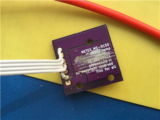

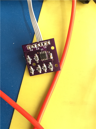

    A few years ago, I probed the function generator to find the signals related to the ramp functionality.
    I found both the sweep start trigger and the sweep sawtooth signal.
    I made a little buffer for both signals so that I could use them as either Y axis for my scope (in XY mode) or as trigger signal in normal mode.
    I still have the little device, but have removed it from the function generator when I blew up its output stage.
    21/04/2014. Go figure ...
