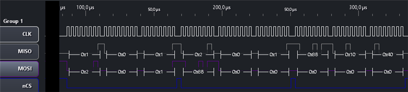

The DAC has a test mode where you can validate if the communication works. A rather nice feature. It helped me getting the control of that device stable.
The IC has two user bits in different registers. If you set that bit in one register, it's mirrored in a bit in that other register.
This allows you to verify the full write -> read cycle. First write the value, then send a read request and validate the returned bit.
The bit to set is the LSB of register 0x02.  It's false by default.
If you set it true, the 7th LSB of register 0x0b is set. If you manage to read that register from your firmware and the bit is true, you know you've mastered both write and read process.
In the code below, I'm setting the 0x02 bit in section 1. Then I ask the DAC to return the value of 0x0b in section 2, and read the results in section 3.

The technical spec describes both the write and read process.
Long story short:
  • write cycle is 8 bit register address then 16 bits of value. It is effective (conditions apply image) at the end of the conversation when the nCS is switching high.
  • read cycle is 8 bit register address with MSB set high + 16 bits of random, then a nop (3 times* 0x00) to clock in the response.
The technical spec does a better attempt to explain this (although that one is difficult to understand too if you're a first time user of that DAC).
Comment below if you want to elaborate on the protocol.
In the picture above, you see this scenario reflected.
  • The first block of 3 bytes sets the user bit in register 0x02 (check the MOSI line).
  • The second bloc requests the value of 0x0b (0x8B because the MSB is set high for reading - check MOSI again).
  • The third block shows that while we are sending the 3 NOP bytes (MOSI), the DAC uses these clock cycles to send the content of 0x0b (MISO line).
note: any MISO values appearing when you're not using a read command are to be ignored in this scenario. Read the spec's daisy chain section to learn why that data is there.

Complete SPI Communication
The whole setup involves some pre-steps. You have to drive the nRESET pin low for at least 10ns, and for good measure, I also send a software reset (0x01 0x00 0x01).
This is the capture of my logic analyser.
Easter egg: the annotations in the picture above are not correct. If you want the right ones, comment below.
