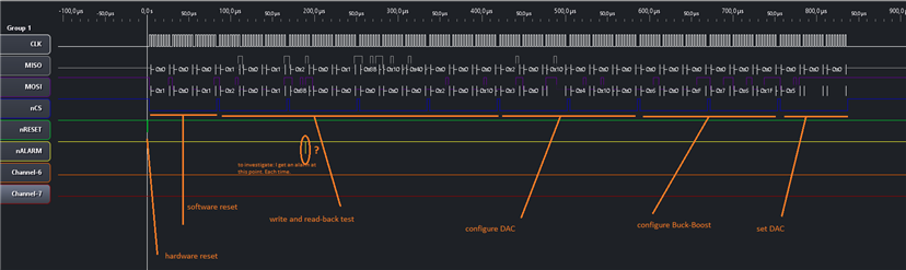

In the picture above, you see this scenario reflected.
  • The first block of 3 bytes sets the user bit in register 0x02 (check the MOSI line).
  • The second bloc requests the value of 0x0b (0x8B because the MSB is set high for reading - check MOSI again).
  • The third block shows that while we are sending the 3 NOP bytes (MOSI), the DAC uses these clock cycles to send the content of 0x0b (MISO line).
note: any MISO values appearing when you're not using a read command are to be ignored in this scenario. Read the spec's daisy chain section to learn why that data is there.

Complete SPI Communication
The whole setup involves some pre-steps. You have to drive the nRESET pin low for at least 10ns, and for good measure, I also send a software reset (0x01 0x00 0x01).
This is the capture of my logic analyser.
Easter egg: the annotations in the picture above are not correct. If you want the right ones, comment below.
